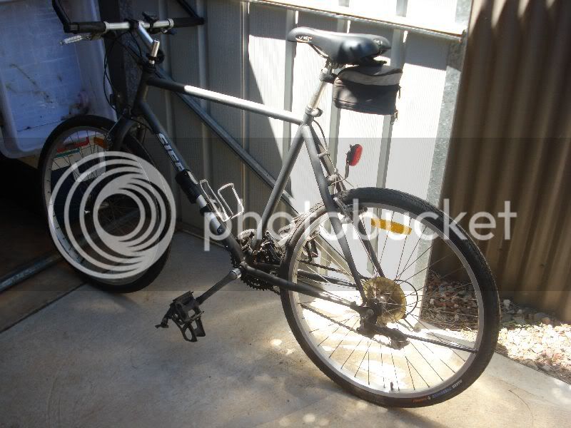

The kit is to be fitted to my trusty, neglected, 21 speed, 10 year old, no-name Mountain Bike... Nothing too special about it, but with the combined brake and trigger shifters I can see an issue with the included bulky throttle.
Disclaimer - Before I go on please note, this is my first time playing with bikes, let alone e-bikes, and therefore I have absolutely no idea what I am doing. If you notice something is wrong (could be done better) from the photos, please let me know. :)

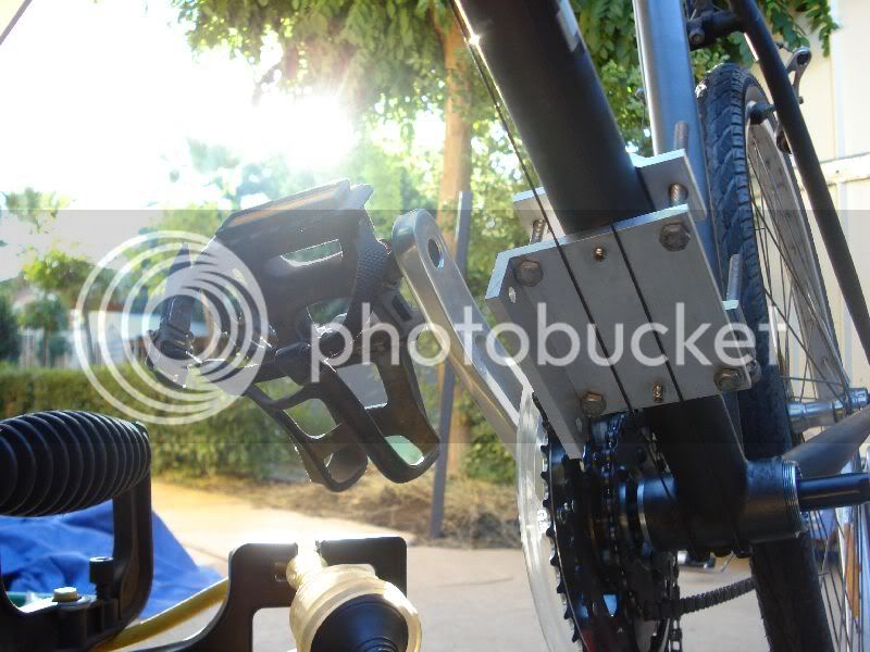

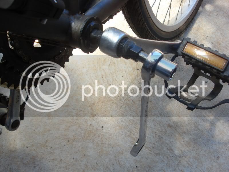

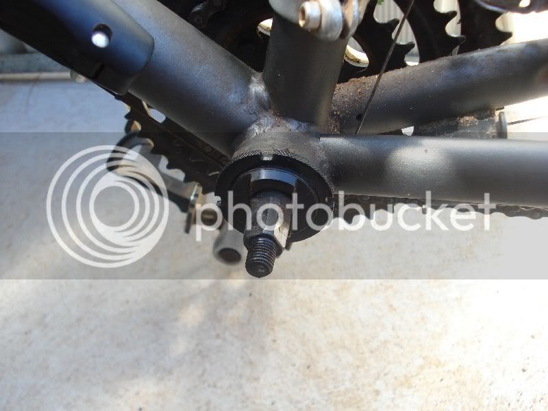

I started by using the included crank removal tool to take the cranks off. Remove the caps, undo a nut and then screw the dark piece of the crank removal tool into the crank and then tighten the chrome part up. As you tighten it more the crank will eventually come away from the shaft.

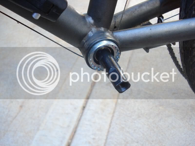

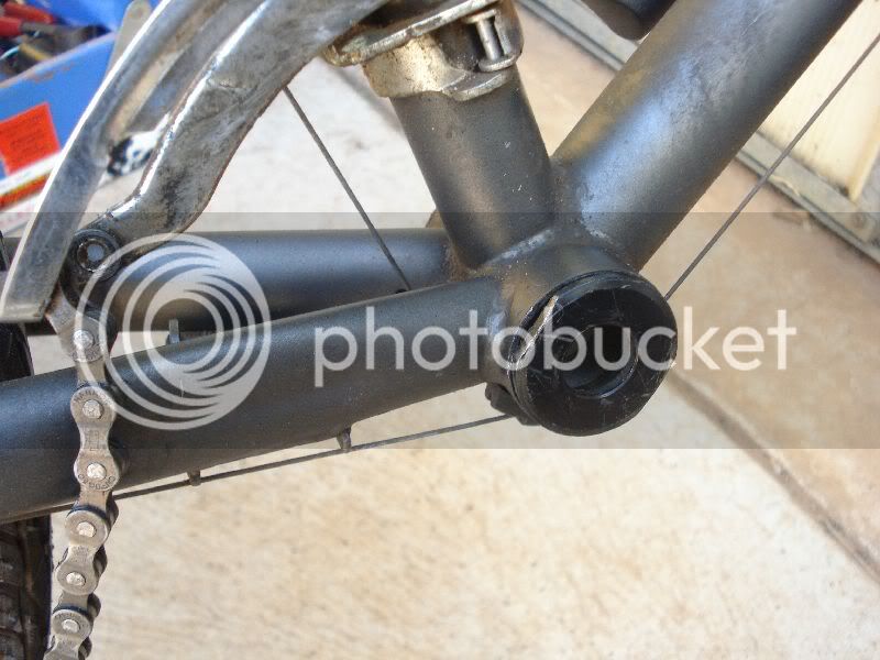

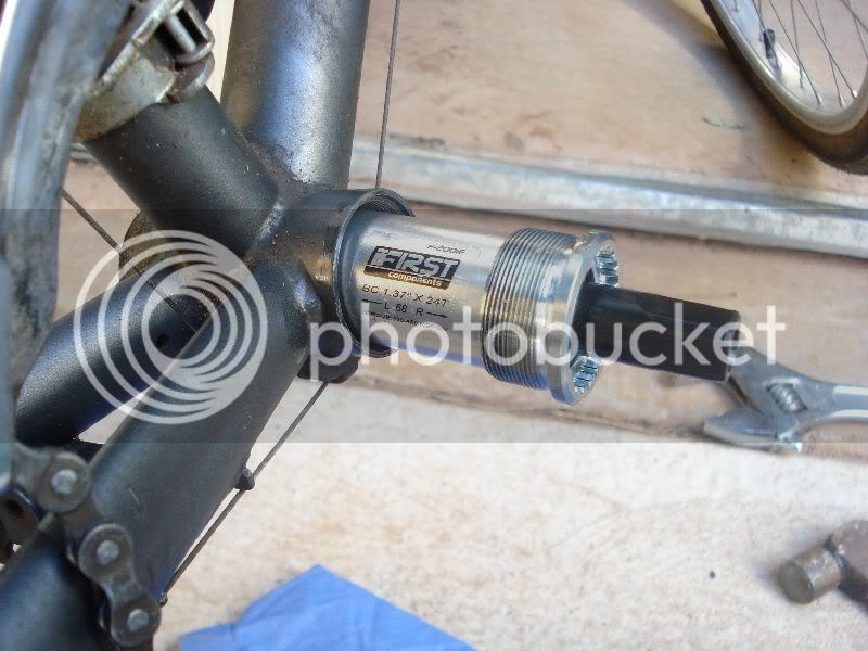

Next was the removal of the left side bottom bracket. I didn't have the correct tool, so I used a hammer and a screwdriver to knock the tab on the outer ring anti-clockwise to undo it. The rest pretty much undid by hand.

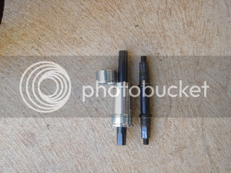

This next picture compares the new spindle with the old. I should've lined it up better, but you can see the extra length out to the left (top) side allowing clearance for the motor.
The next pic shows the old right side bottom bracket. Dopey me forgot this would be left hand thread, so you turn it right to undo it.

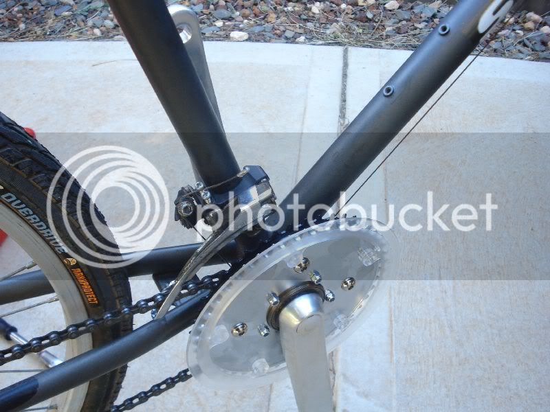

Here is the new right side bottom bracket going in. I put grease all in the threads and on the body. I'm not sure how necessary that is though. Should I have used some sort of Loctite (thread lock) instead?
With the right side screwed all the way in, this is how the left side sits. I am a bit concerned by this as there is a gap between the left bracket and the bearing of the right side which would potentially get full of gunk. Should I be worried? :shock:

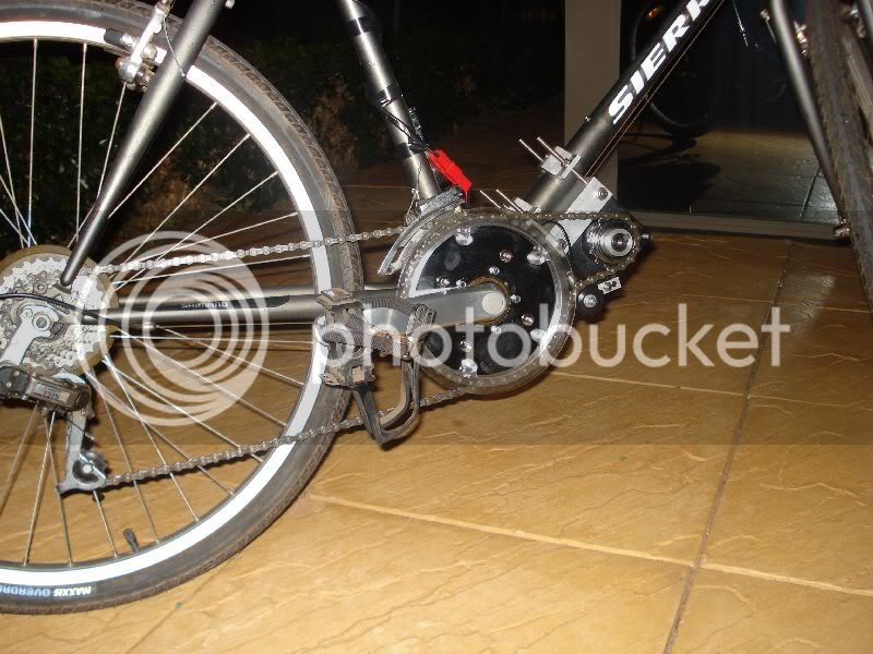

After all the bad things I've heard about the Cyclone freewheel I decided to put a bit extra oil around the edge. Not sure if this will help or hinder it though. I had planned on getting an ENO freewheel, but I'll see how long this one lasts first. So I screwed the right side crank into the freewheel/chainwheel set and fitted it up, using the bolts to drive the cranks onto the tapered shaft. I am guessing the crank and freewheel will tighten up more after a bit of riding. Thoughts?

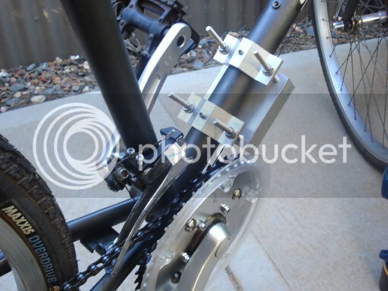

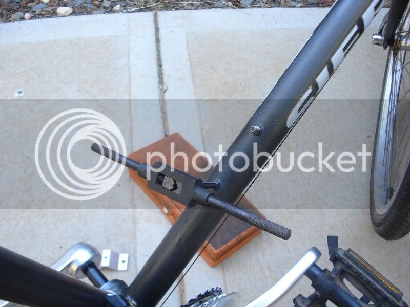

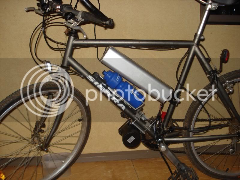

Motor mount time. I tapped the bottom bottom thread of the drink bottle mount to suit the motor mount's grub screw and also drilled a hole so the grub screw underneath could go into the steel frame.

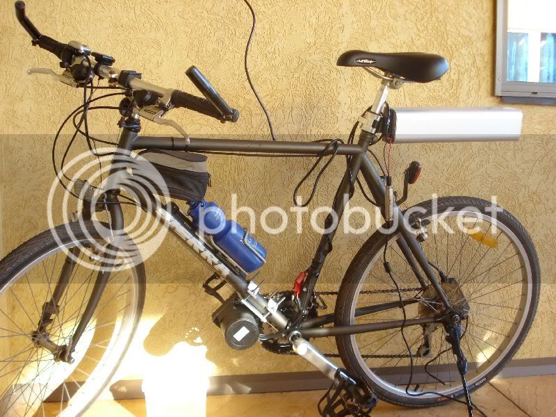

Like most of my projects, this took a lot longer than I expected and after starting at lunch time it was now getting dark and I was getting frustrated and impatient. Sorry, but no pics of the actual motor install here. I took some links out of the chain and fitted it up. The motor seems to be sitting forward more than I expected, but the chain alignment doesn't seem too bad.
Screwed the 2 screws into the battery pack and clamped it to the seat post. It seems very solid.
Fitted the throttle up and, as expected, where I wanted the throttle impeded on the gear trigger action. I'll see if I can move it, or swap it out for a different style of throttle.
Next was all the wiring to be run along the frame. Still some tidy up work to be done.
Those last pics were taken after my initial test ride. I don't have a watt meter to show how much battery was used, another thing on my list of wants. I only went for a few minutes just to see what it was like and whether there were any issues going to raise their heads. Thankfully it all seemed to be a success. I plan to have a better ride tomorrow.
Still to go.
Tidy wiring, fit heat sinks to the motor, adjust the throttle position. Get a watt meter. Have fun... :)

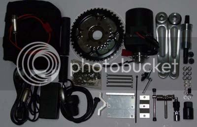

Cheers, competitions. You asked for install pics in your thread, so there ya go. :)
The kit is exactly as supplied from Cyclone-tw.com except for the extra hard case for the 24v/10ah LiFePO4 battery.
There's (bad) pics of it laid out on my table at http://s806.photobucket.com/albums/yy343/eeesickle/, but the pic from Cyclone-tw.com shows it better. I'll itemise it...
What's in the box.
Motor pre-fitted with gear
Chain for motor
Heat sink fins for the motor.
Motor Chain Tensioner - Not sure of the tech term, but the provided plastic cog uses the supplied Spring and Cable Tie to provide tension to keep the chain on the motor and main chainwheel gears.
3 ring chain wheel fitted with Dicta freewheel for the cranks.
2 x cranks
Twist throttle with battery level LEDs and on/off switch.
Rubber handlebar grips
Cartridge type bottom bracket
Bottom bracket tool, crank removal tool, freewheel tool and chain breaker
24v 10ah Battery (extra US$20 for hard case like mine)
2ah Charger
Nuts and bolts (I ended up with 4 nuts left over that I'm still trying to work out what they're for. Maybe for external controller?)
Tools I used.
Spanners and adjustable spanner
Drill
Tap
Electrical tape.
Allen keys for grub screws and the throttle grip.
Sockets to do up the cranks
Philips Screwdriver to do up battery mount.
Cable Ties
Ummm. I think that was it.

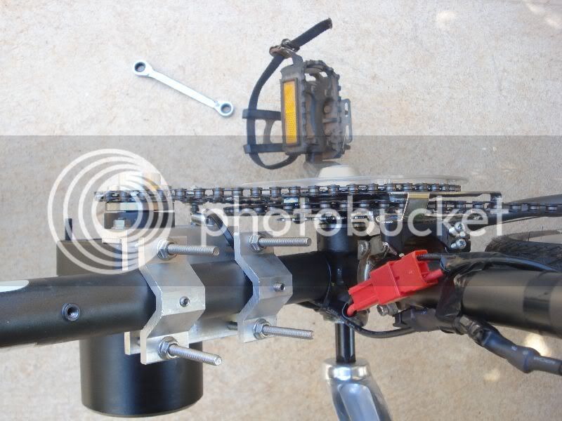

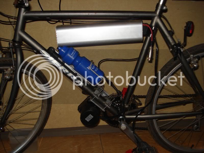

A suggestion for more centralised positioning of the battery weight leading to better handling. You have an uncommonly large frame triangle so it looks like it may actually fit. Alternatively for even lower positioning you could flip the battery enclosure vertically from the position pictured above, clamp it to the bottom of the seat-tube so sits on an angle above the down-tube. However you would have to remove your front derailleur (not needed anymore anyway) and trim the excess length off the motor bracket bolts.
PS: if you miss your previous gear range lost through the fixed front chainring necessitated with the Cyclone kit; Look into installing a SRAM Dual Drive hub. You'll get your entire gear range back for a truly versatile goat-track climbing/velodrome hammering go-anywhere machine.
Oh and put some silicone sealant around the grommet where the wires enter the motor. These motors downfall are moisture getting inside.
Very nice PhotoChop, boostjuice! Thanks, I never thought of putting it there!
You are right, it is a large frame. I requested it when I bought it many years ago. :)
This is how I have it fitted up at the moment, but after your suggestion I think I will look into changing it.
On charge after a quick 4km ride...

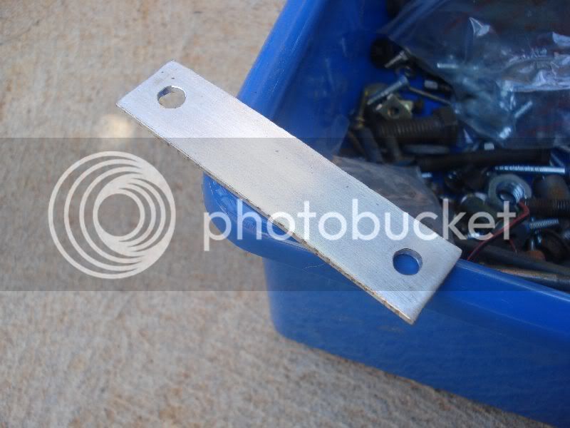

Before I went on a ride I was looking over the bike and pedalling around the back yard. It just didn't sound right and on close inspection the alignment was causing the chain to grab on the gears. I decided that a 3mm spacer would bring the motor pretty much back into line, so I knocked up this...
I didn't want to just add a couple of washers, as I thought the motor needed as much support as possible. And after fitting it I am very happy. There is no longer a grabby chain noise. The only other change I would make is to screw in the chain tensioner slightly, as it seems to force the chain over slightly as it feeds to the main chainwheel. Having said that, it ran very well under power during my ride.
First Ride Impressions
So for my first ride I rode 2km out, with half of it being a straight, slight climb. At a steady pace this ride normally takes my unfit self about 12 minutes, and 10 or so back. This time, for the first kilometre I manually pedalled and then half to 3/4 throttled up the hill while pedalling as well (Top ring 6th gear), speed was 25-30kph. The e-bike smile was huge! :D Time for the trip one way 5 min 40 sec.
I got back and the motor felt a bit hot. I'll fit the cooling fins once I have the appropriate heat transfer paste. I'm happy with how it rides, although the weight is noticeable, and I can see boostjuice's idea helping with that.

Okay, does anyone see a problem with mounting my battery box in the following way? The BMS would be down at the bottom and from my ride today there seems to be some movement from inside, so some packing may be required. This first way makes it a bit easier to get at my drink bottle and I guess the centre of gravity is lowered a bit more too.
The next way would be perfect if it ran straight along the frame, but unfortunately it doesn't. It also impededes on removal of my drink bottle more.

Agreed. Keeping that weight as low as possible is worth the effort. Time to trim those overly long motor bracket bolts and tap some new threaded holes for your drink bottle holder :wink:
Unless....I suppose there wouldn't be enough clearance for this arrangement?

I agree with KiM, if you don't need the bottle while riding, another spot would be behind the back reflector.

I'll lop off the motor mount bolts and see if it will go close to fitting that way.
