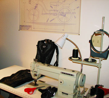

Workstation:
I bought a Tacsew sewing machine.
Note: The blueprint above the sewing machine is a copy of my first electric vehicle that I designed and built in college.
It is a challenge to operate, although I am becoming better skilled at it with each hour spent. My unit came with the table and lamp; the motor (not shown) is mounted below. When engaged it makes an audible hum – especially upon spin-up, though not unpleasant. You really need three arms to use this device:
  • Right foot is on the pedal, and
  • Right knee lifts/releases the Walking Foot.
  • Left hand guides the material
  • Right hand does double-duty slowing the right belt-driven wheel, assisting in preventing runaway rotation when not guiding material, and
  • Right forearm depresses Reverse-Arm (below the Tacsew label and thread-spacing knob).
I have figured out that wearing the right glove greatly helps me control the speed of the belt-drive without blistering my hand. A 1000W rheostat/speed-control would be perfect. (One of the features included in the Artisan machine).

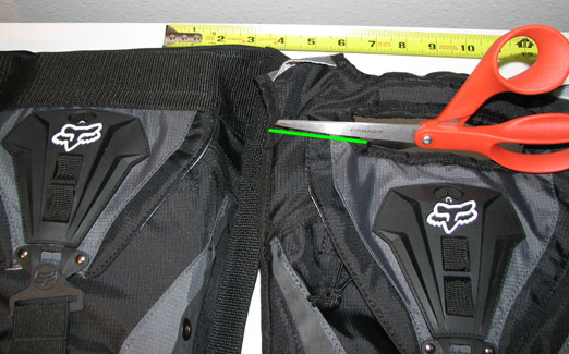

The first time I did this it took a bit of time and study to figure out exactly what needed to come off. The second time though went a lot faster because I now knew how the bag was constructed and therefore could execute cutting without a worry.
In the image below there are two bags: The top row is the unmodified Fox bag, Front View on the Left and Back View on the Right. The bottom row shows the first bag already modified in the same corresponding views: It’s longer, reinforced, and has a strong side-flap added along the length where we’ll join the bags together.
EDIT: was "top-flap"; is now "strong side-flap..."
Let’s remove the straps. Flip the bag over so we see the backside with the bottom edge pointing up. Cut the bottom left and right straps off as indicated along the green line right up next to the seam; it’s ok to leave a little bit of material – no need to be perfect. The bag on the left has been completely modified and is shown for reference.
Flip the bag over so we see the front side with the top pointing up. The Fox bag has this handle-feature; a cutout that looks like it’s designed to be a handle when it’s not on your back. We need to cut this part off along the lower edge of the handle on the left side as indicated by the green line, and again on the right; just cut right through so it is nearly level all the way across. This action removes straps entirely. The bag on the left is completely modified and shown for reference.

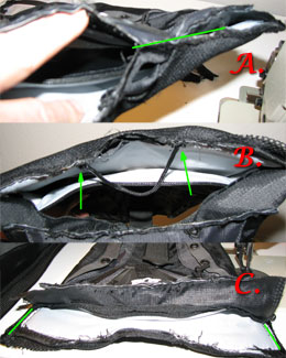

Let’s get our trusty Seam Ripper now and prepare to remove the Grosgrain Ribbon securing the front flap to the front face. In the image below, Figure A shows the bag after the cuts have been made in the previous step.
I find it useful to pin or staple loose pieces of material down so they don’t wander and become misaligned. The top flap is a critical piece of the bag, so where we’ve made the cuts – let’s staple the top flap back to the top face (take care to not staple all the way through the entire bag). Figure B shows where I have stapled the left side, and about to staple the right. Part of the Grosgrain Ribbon has been removed.
Note: If you’ve never used a Seam Ripper before you might want to play with it on some old shirts or rags that have a hem to get the hang of it. The red ball goes into the pocket of the seam, and gently pressing forward with a slight wiggle causes the knife edge to cut the stiches. Be careful though for it’s easy to impale yourself or shred the material! :cry:
Figure C shows the Grosgrain Ribbon completely removed, and the red lines point to both staples which are securing the front flap to the front face.
Step 3: We need to finish opening up the pocket...
so take the top of the bag and spread it open along the same line where we just removed the Grosgrain Ribbon; in Figure A, by using my middle and index fingers to create the effort and the other fingers holding the bag (yeah – it’s a bit precarious; kind of a challenge to do solo), with the other hand use the Seam Ripper to separate the two halves.
Figure B shows how this action opens the pocket. Next we remove the small polyethylene rope at the two points indicated by the green arrows.
Lastly, we need to make room to add an extension to the top of bag, and we do this by ripping open the seams on the left and right sides as indicated in Figure C; about an inch or so is all that is required. Note: Don’t go past the horizontal zipper least we introduce new alignment problems! :shock:

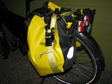

For those without an industrial sewing machine, you might also look at various other items. I panniered two 24v nicad packs very nicely for awhile, using one bell handlebar bag for each 24v 8 ah nicad pack. A pretty good fit for 4, 5 ah turnigy bricks too. So two attached like panniers to a rear rack would easily carry 72v 10 ah.
Other off the shelf options, soft lunchboxes. Some are cheap crap, others look pretty stout, and may be shaped good for carrying lipo. Another option are water bottle sleeves. Quart size ones also look about right for 4 lipo bricks. Womens purses, the list goes on and on if you are seeing instead of merely looking at stuff.
Want some really big, but narrow panniers? Have you even looked at laptop bags? 12x 16 x 3" Perfect for carrying a shitload of lipos.

Are hard containers better at protection? Yes – they are ideal, and greatly preferred. One day I hope to craft or contract them. For now though, a reinforced toughened soft-bag is the next best solution.
Vibration is inherently attenuated by softer containers if the entire assemblage is well-constrained, and movement of the unit as a whole is restricted: This is the goal of the present construction.
Locking & Security issues are noted; all soft-body assemblies – including plastic enclosures have the potential for tampering and theft. This is a good subject worthy of deep exploration. :idea:
Novara Trunk Bag: I have one (not presently used though saved) and I ended up padding the batteries to keep them from being jostled about within the container. The second feat was overcoming the insufficient frame-fastening mechanisms; mine wobbled about on the rear rack until I had an epiphany at the bike shop: Use an inner-tube to secure the bag:
This is picture is taken after the 2010 Flying Wheels Century event; the Novara bag is held down by a crisscross overlay of a typical 26” tube stretched over and knotted off. Let me see if I can enhance this photo…
The top red arrow points to the knot, the two lower arrows point to the crossovers – and it you look closely you’ll see that I also have a layer of ½ inch white closed-cell packing foam between the bag and the rear rack for additional padding. The tubing, acting like a giant rubber band, proved superior in securing the bag in place; no wobbling inside or out, and no worries. (Apologies for not having a better picture of this unique configuration; it worked really well) :)
Sewing machines: I believe that the Tacsew is probably overkill for this particular project; however I also attempted fabrication of armored soft-bags and for those sorts of tasks this is the class of machine required. I am considering a fetching a lighter-class industrial-grade sewing machine that is easier to work with, supported by a range of stich-patterns implicitly. The question though arises: Am I a design & prototype-oriented business or a production manufacturer? :roll:
I think as a hobbyist that a sturdy well-built consumer-model sewing machine can handle the type of work we’re describing here so long as we identify the importance of being able to use:
  • heavy-gauge thread,
  • frequent replacement of strong sharp needles,
  • keeping it well-maintained and oiled, and
  • able to handle material thickness up to ¼ inch.
If your machine can do seat cushions, bean bags, curtains, and bedspreads – there’s good reason it can handle this job! :wink:
