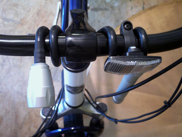

The bike arrived to my office today. Opened the box to get the battery out for charging. Very well packaged. I didn't bring any tools. I didn't bring my tire pump. The plan was to take it home.
Upon examining the bike, it's 98% assembled. Tires are full. Tools were included to attach the pedals and handle bars. A few quick adjustments and ten minutes later it's ready. Battery finished charging. Lets ride!
Took a spin around the mall shopping center and went up the street looking for the steepest hill I could find. Went up the 9.4% grade quickly, with ease and no pedaling. Only problems so far are the front brake pulsates when braking and a broken seat mount.
Rear spokes are much thicker than the front spokes. Brakes are noisy, but stop well. Shifts between gears very smoothly even at low speed. Has a granny gear for hills, but top gear does not match the top speed of the motor on flats. I enjoy the up right riding position and ergonomics of the handle bars. The stitching on the grips is a nice touch. Paint job is very nice. Even comes with a bottle of touch up paint. Overall fit and finish is quality. Battery slides in and out with ease and the bike does not feel top heavy.
Noticeably faster than my other ebike around the neighborhood. Zipped right up the 16% grade w/moderate pedaling.

After testing the bike yesterday I removed and adjust the shifter, throttle, and brake levers to better suit my riding position. Front brake pulsates, so I tightened up the front fork, cleaned the rotor, took the front caliper apart and reassembled it. neptronix wasn't kidding about the noisy brakes! They sound like ass.
First commute to work today with the iZip Zuma.
No pedaling. (ok ok I fake pedaled when a cop rolled by, but it was no effort!)
5.3 miles each way, 14 traffic lights, stop and go
4% mean grade average rolling hills
tires @ 50psi, 200lbs rider, estimated 15lbs of gear
22 minutes to work, 25 minutes home, 20 minutes by cab
front brake shutters and squeaks
motor is whisper quiet on flats
pulls strong from a dead stop up hill
On the way to work I noticed less rolling resistance when coasting down hill than my other ebike. I got to ride home in the rain, lucky me, I brought my rain gear. Tires gripped the wet road, and the brakes were strong. (and quiet too) Front shocks and pneumatic seat post absorbed all the bumps. It was a comfortable smooth ride to and from work today.
The ride home felt much slower than on the way to work. Time to upgrade! j/k (I just wanted to get out of the rain.)
