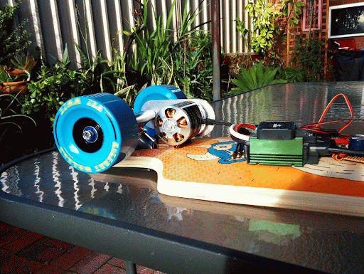

Pulled out my 8 x 6S 2.2Ah batteries that have been sitting in the shed for a year and charged them all up. 4 of these should get me going.
Post man has been busy delivering most of my parts this week. I'm yet to receive the Quanum Rx/Tx from HK.
Have mocked it up today. Will pluck up the courage to weld the truck mount tomorrow, but have to bore out the pulleys first to check alignment and clearances.
I do like the look of the drop through Comet deck. I have another regular mount deck if this one proves too low.
97mm wheels look comically large, but I needed the clearance. Once the 1/8" shock pads go on I'll only have 20mm clearance from the ground. And the motor can will also be damn close to the deck too. I'm unsure here as to what's the minimum I can get away with - might have to cut down the top of the mount to get full turning radius.
Will solder two of the 50V 330uF low ESR capacitors close to the ESC for ripple.
BMS is from Bestech, 80A continuous for a one plug charge/balance. It is enormous and mostly unpopulated since it's good for up to 24S. Not sure I'll use this.
Heres a fake motion photo courtesy of Google auto awesome.
4ajzYx1h-Tg
I'm setting up a front wheel drive.
If I have regular foot stance, should I have the pulley on the left or right front wheel? Specifically when turning do you tend to turn one way sharper hence need fractionally more clearance on that side? Or does it make next to no difference?
I dont know if drop through is a good idea. looks like you'll have clearance problems.
being front wheel drive is a smart idea with this setup though - Because i think if that mount was at that angle on the rear truck it would likely hit whenever transitioning from road to footpath - down driveways etc.
It looks like you're taking clearance measurements at the hanger, but the mount looks like it is sitting lower to the ground at the motor end.... i would recommend the motor angles the other way - towards the deck.
take your board outside and sit the front wheels on the road and have your back wheels still on your driveway - push board back & forth a few times at different angles... if the motor mount does not scrape the concrete edge that is near the gutter go ahead & weld that puppy on.

Well spotted, the motor end of the mount is sitting a few mm lower. There is some extra metal I can remove...
That's a good idea. Will stick it all together and try the "mount the kerb" test tomorrow.
