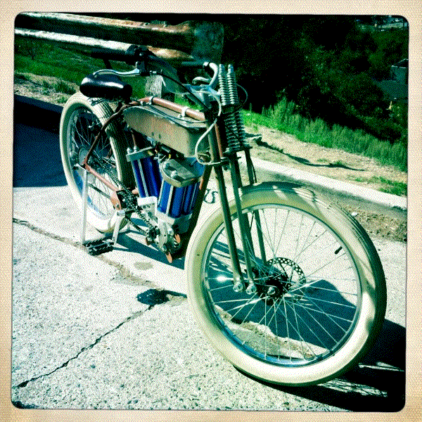

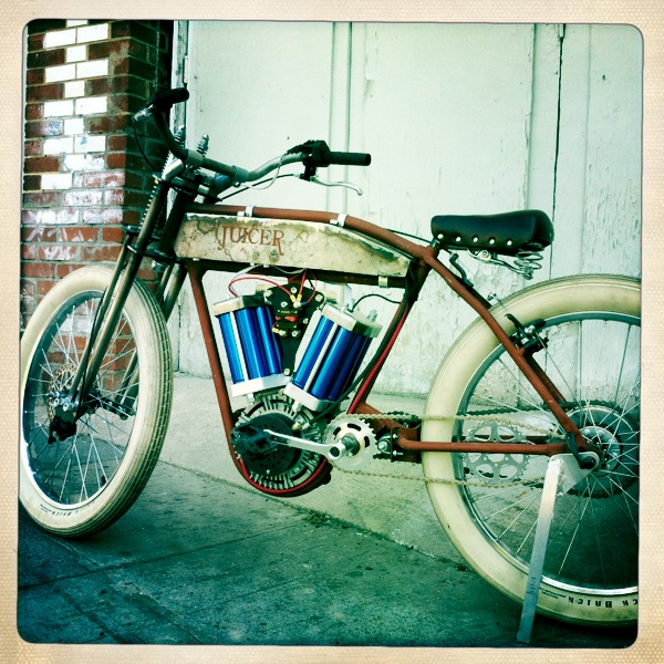

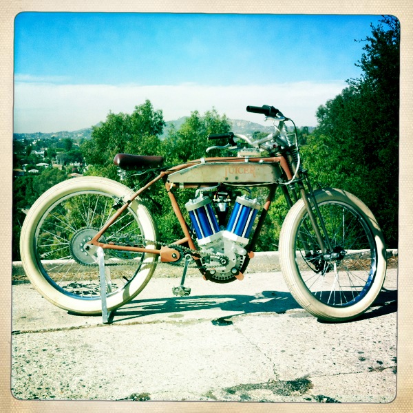

Customized Worksman loopframe
Custom springer fork using "Brain Fork" elements
16s1p 48v Headway 40160s EV-Twin
Manta (Refurbished Etek?) PM motor
100a EcityPower BMS

Hillhater asked about the gearing. So I am running eleven teeth at the output shaft which drives a 23t sprocket on a free-wheeling coaster-brake (freecoaster). Welded to the shell of the coaster-brake hub is a standard 16t sprocket which drives a 44t final-drive sprocket. You can see it a bit better in this picture;
This arrangement is better than Juicer 1, whose clutch was at the output shaft, because now I am only dragging one chain around while coasting. Also Juicer II is a bit more modular in its battery pack. Early test-runs revealed a weak cell needing replacement. The above pic shows how I was able to swap out the cell with minimal disassembly.
So once that was sorted (and the rain dried up) I was able to do some more rigorous testing. I live in the hilly neighborhood near Dodger Stadium, and I am pleased to say that Juicer II, even with the controller limited to 100a, can climb nearly every hill. On the flats, I clocked forty-six on a slight incline. After recharging at the public tennis courts by Griffith Park, I went on a range-testing ride on the LA river bike-path. There I was able to confirm that Juicer II has mind controlling properties when a cyclist in distress flagged me down to use my tools. He said, "Is that an old Indian?" which is exactly what I wanted him to say. Nevertheless, I corrected him, saying, "No, this is a Juicer." and slid him my card. So up to Burbank and back, we went 12.7 miles before the BMS went into protection mode and cut off the juice. That happened not too far from this giant soccer-ball;
So there's some preliminary performance data, KiM. Another datum is weight; 111lbs using the bathroom-scale method. Yeah, those forks and wheels are heavy. So although I'm not satisfied with the top speed, I am happy with the power and range, and I'm sure if I upgraded to a 160a BMS (Yesa?) I'd tap more of the Etek's potential.

so your reduction is 5.5:1
Which would mean the motor is at approx 2200 rpm at 30mph..
.. and 45mph if you can get up to 3500 rpm (max on 48v ?)
but what is it,?.. and what are you expecting, more or less ?
He said he clocked 46MPH on a slight uphill, so I would guess near 50mphget on flat ground, pretty good!
