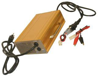

something like this could be suitable..
http://www.bmsbattery.com/alloy-shell/25-alloy-shell-240w-lifepo4li-ionlead-acid-battery-ebike-charger.html
For the motorcycle I used a smart charger from batteryspace... very simple job, just disconnect the controller connect the charger and wait for it to charge, thats what Im use to right now so I guess I will have to do some reading on the Lipos...
