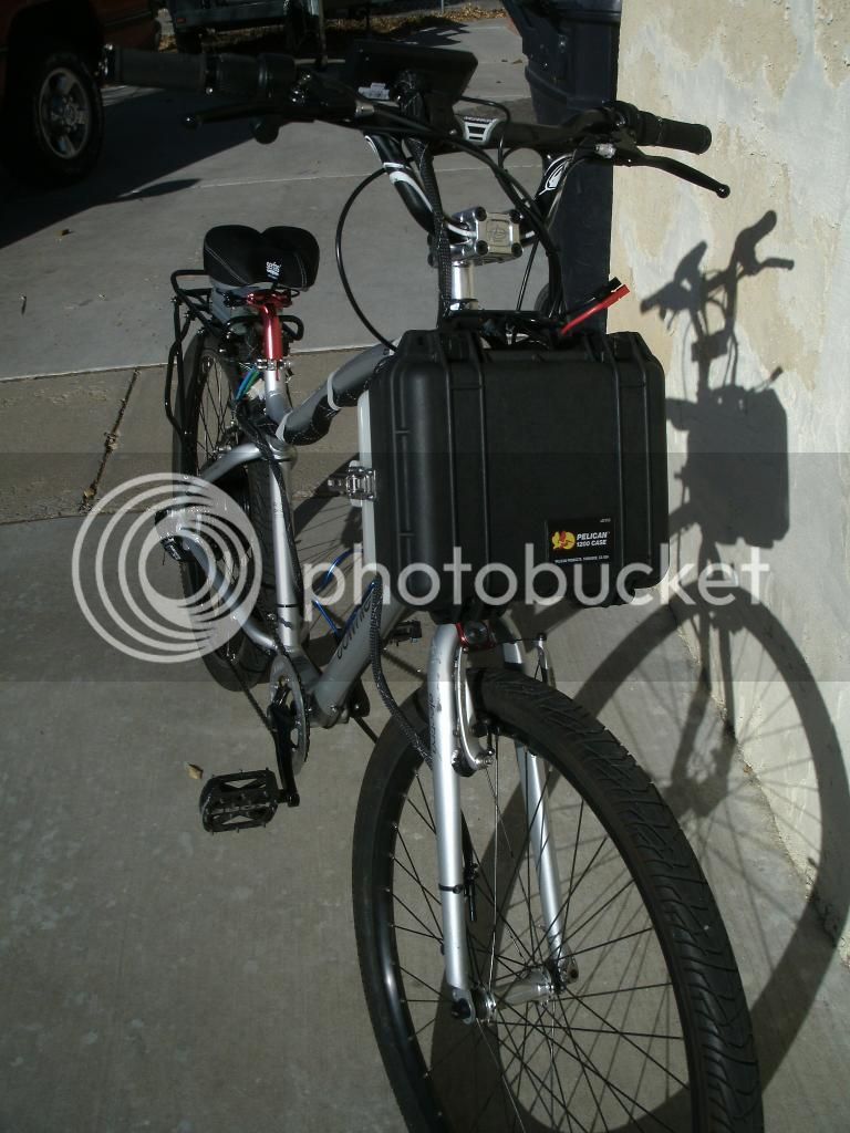

I've recently finished my first e-bike build. It took me a while as I had to keep ordering various connectors, more batteries, new charger, power supplies, etc... I didn't really know what I was getting myself into, and I became a bit frustrated at times. However, I am MORE than happy with the finished product. It came out fantastic and performs far better than I had imagined it would.

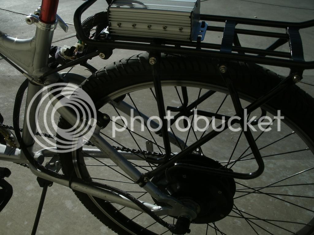

Anyway, as you can see, it is an Electra Townie that has a MAC 8T geared hub on the back. I purchased the hub/controller setup (along with a bunch of parts and accessories) from Paul (Cell_Man) at EM3EV.com. He was incredibly helpful during the order process. The controller has 9 3077 FETs and is limited to somewhere between 25 and 30 amps (can't remember off the top of my head.) There is an 8-speed freewheel mounted, but I didn't put a spacer behind it. So, I have the derailleur limits set to the other seven cogs. With the small chainring up front, I don't really need that last gear, anyway. I might use a spacer on down the road (if I take the back wheel off at some point.)
The battery pack is comprised of 6S 5.8 Ah "compact" Zippy packs. I used six batteries and have them set up in a 12s3p configuration. I bought the packs from HobbyKing. From the start of the project, I knew I wanted to have a "modular" battery pack that was very secure yet could easily be removed from the bike. Part of the reason is for charging, and the other is so that I can take the battery with me if I go into a store or have to leave my bike locked up outside somewhere. The Pelican case has some foam inside and keeps the batteries held very securely in place. The mounting interface is a plate of nylon that is held to the long headtube by some clamps that I machined. I also machined some "pins" that mount on the feet of the Pelican case. Those precisely locate to holes machined in the nylon plate. Once the pins are inserted into the holes, a pair of stainless safety latches ensure that they won't work their way out. Everything has a very clean fit, so there is no rattling whatsoever.
In terms of performance, this bike cruises and handles far better than I anticipated that it would. The top speed (on level ground) is around 31.5 mph (50.7 kph). Having the battery on the front of the bike really makes it corner well. Also, since the battery is attached to the frame, the extra weight isn't felt in the steering. It uses around 500 MAh per mile. I do a little pedaling when first taking off. However, I run out of gears by the time I reach 20 miles per hour, and the motor doesn't feel as though it wants to go any slower than that. The hub is virtually silent unless you're accelerating. Some have said that the MAC hub is noisy, but this one is quieter than any of the DD hubs that I've heard. The ride is also very smooth and solid. Even though there is no suspension, I don't feel uncomfortable on bumps. The gel seat has a couple springs beneath that help soak things up.

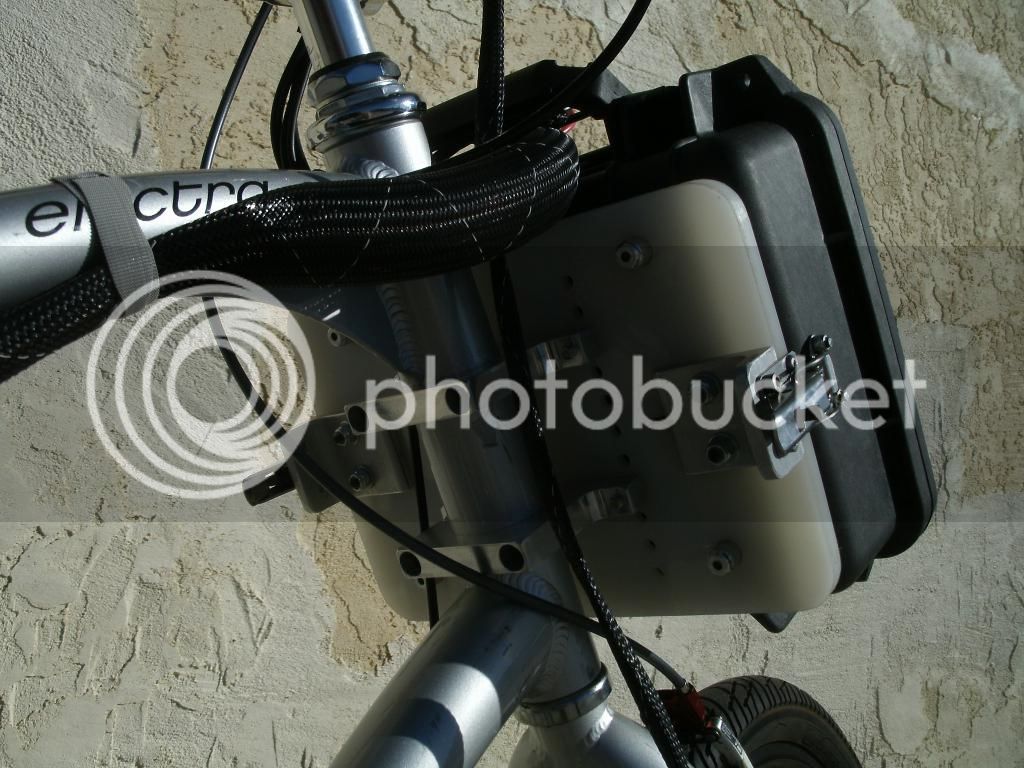

The front mount battery box looks pretty neat - oatnet would be proud :D. There's a growing interest in this type of mounting solution - maybe you could get a couple of extra shots of the plate face and box when dismounted to show more details.

teklektik, thanks for pointing those links out. What I meant was that this is an awesome solution for quick release so you remove pack and recharge easily.
love the front mounted battery latching system.
Gotcha - me too. Using them in concert with the guide pins as a two part solution seems an effective approach.
I like your improvements to the front pack - mounting straight to the frame eliminates a lot of obstacles, and yours is the best frame mount I have seen so far. I liked Gensem's epoxy version, but IIRC the epoxy eventually failed. A removable pack makes LiPo easier to manage, Mattycii sorted out a great methodology for a larger pack, but yours is nice and streamlined and I think better for a mid-size pack. Nice vision and implementation, thanks for sharing! :D
