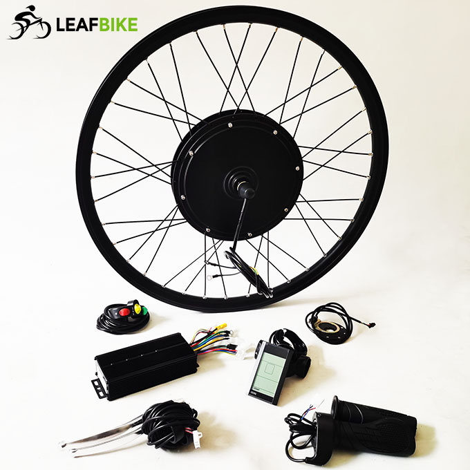

This is the kit I bought, it’s marketed as 60v

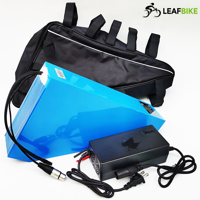

I also confirmed with Leafbike that the kit would work with the battery they sell. This is what I bought

The most common causes of what you appear to be seeing:
--wrong phase hall combination. This would be eliminated by disconnecting the hall sensors, if the controller is sensorless capable.
--poor connection (excessive resistance) between controller and motor phase wires. Only one of them has to be a problem to cause this.
--damaged FETs in the controller in one phase, not actually blown but not operating as they should; sometimes it's not the FETs but a gate driver instead.
--Controller current limit settings, if any--if the limit is too low, the motor would stall under any load higher than that limit.
Unlikely to be a battery or battery connectoin issue, if there's no "brownout" under load and the controller is sold to work with this specific battery.
If it's an FOC controller (unlikely) then it won't correctly operate the motor until it has been fully setup and "tuned" to the specific motor, etc. That usually is done via serial cable and PC program, or bluetooth and a phone app...if they don't supply those with it then it's unlikley to be an FOC controller as those would be required to be done by the end user with their specific system parts (unless the seller provides a completely configured kit including battery/etc, which is very rare).
After much back and forth troubleshooting with Leafbike they have sent me three items free of charge. The new parts are due to me be here in a few days. I'll do some swapping and hopefully fix the issue.
A replacement 18 MOSFET 60v 40 amp controller (same as what I currently have)
A new 24 MOSFET 60v 55 amp controller
A new LCD screen (LCD-003 on their website)

I am happy to report that switching to the silver 55amp controller fixed the issue! This thing absolutely rips.
