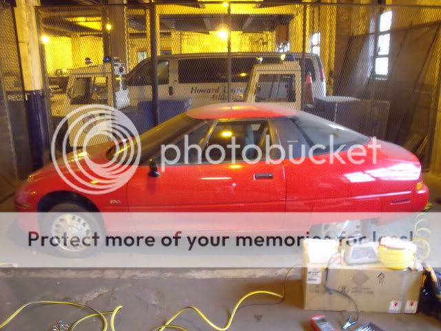

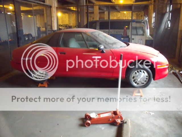

The car is in a small fenced-off area in our University's service center (basically a parking garage with some shop equipment that I'm not allowed to use):

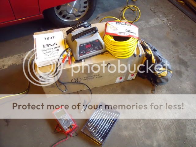

These are the immediate tools of the trade. The cardboard box contains the repaired and refurbished motor controller/inverter, which is the biggest key to the whole project. It will accept a DC input voltage range of 200-400 V and is controlled with throttle and braking pots (5 kohm). I'll open the box up once I'm ready to start turning the wheels. For now, I need to work on the 12 V system and getting the caps installed.

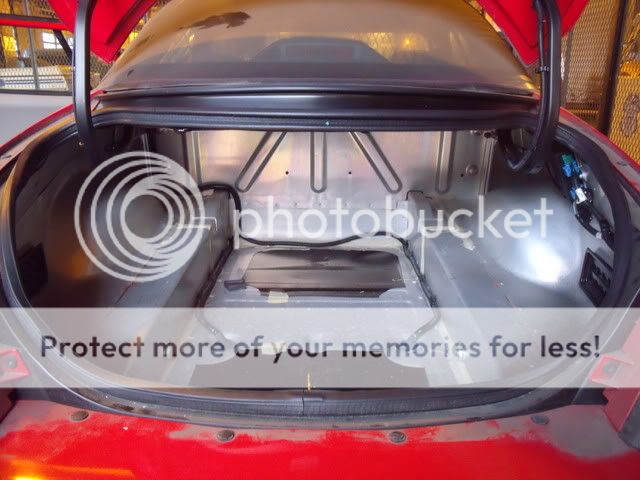

Here's the trunk space, in which I hope to fit some kind of ICE and generator pair. It's a deep trunk, but not a tall trunk. That will be an interesting design.

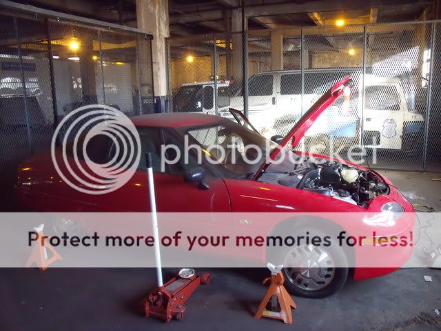

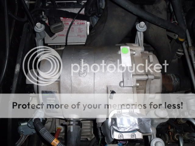

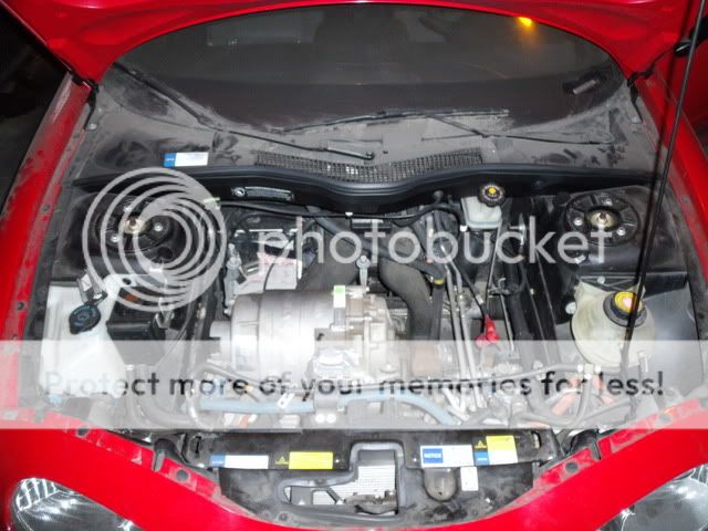

Here's a look under the hood, and a close-up of the motor. The motor is usually concealed underneath the inverter, which is mounted above it when installed.

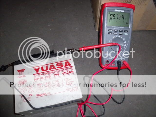

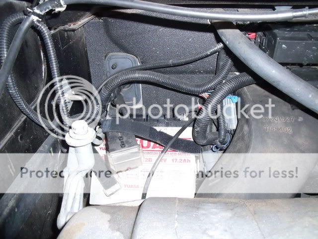

Here's the small 12 V auxiliary battery, which is kept charged with the DC-DC converter mounted alongside the inverter. The battery had sat around for several years, and was a lost cause.
I replaced that battery and charged it in place.

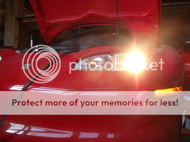

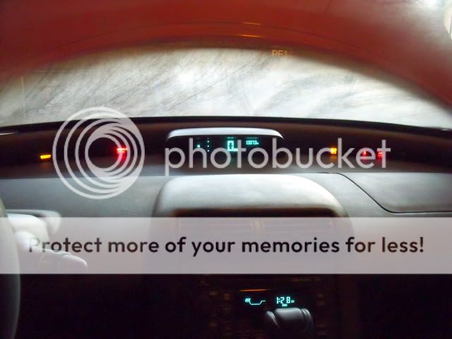

Supplying the charging voltage to the 12 V bus allowed me to test the vehicle's auxiliary systems. I cracked the startup code and got the radio, lights, and dash working.

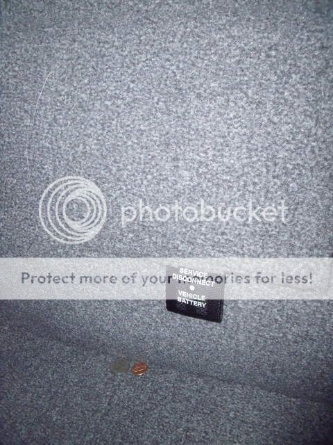

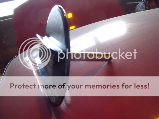

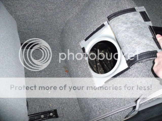

One interesting item is the high-voltage service disconnect which was in the cabin. It's basically a pin that was used to connect the series of VRLA batteries that the car used before you'd take out the battery tray. Here's a photo of it sitting on the roof.

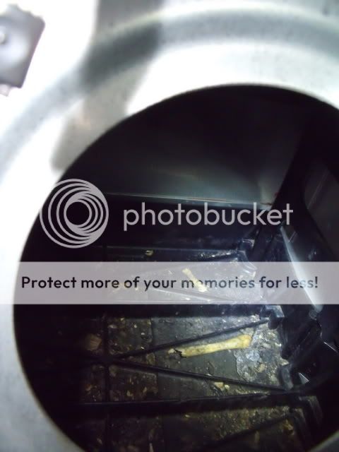

The disconnect is supposed to be placed behind the driver's seat. Here's the flap. When I opened it, there was just an empty space behind it rather than an electrical fixture.
Inside: rat manure and chicken bones, which they had dragged up inside the car to eat at their leisure. Cleaning the battery tray out is going to be a pleasure.

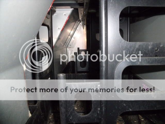

Here's a view inside the T-shaped tray. All the VRLA batteries have been removed. This is now the space that I'll use to house the ultracaps. There should be plenty of room.
The battery tray, which I mentioned is T-shaped, drops out from underneath the car. I needed to get the car on jack stands (no lift available) and will drop the tray out after removing all the bolts. Getting any vehicle up on four jack stands is a scary job to do by one's self, especially with only one floor jack to use.
Luckily, I found a method that worked and should be in good shape to drop out the tray soon.

pwbset, no reason to not post the four jack stand method here. It's not bulletproof, but worked here on a relatively flat concrete slab.
1) raise driver's side (DS) front, first jack stand under front DS axle.
2) raise DS rear, second jack stand under DS rear suspension point. (Note: this the most dangerous time. The stands must be as low as possible to keep the car from rolling where you're about to stand.)
3) raise passenger's side (PS) front, third jack stand under front PS axle. When you do this, the floor jack should be at a non-perpendicular angle to the car's sidewall, as it may try to roll towards you when the front tire comes up. Also, check jack stand #2 often as the car may "float" above the stand you put there earlier as you get the PS raised higher.
4) raise PS rear, fourth jack stand under PS rear suspension point. Let the floor jack down slowly, realigning the rear jack stands as needed. The front jack stands should stay put.

I took off the top cover, cleaned out the tray a bit (more yet to be done - I want a hose and bleach), and tested the fit of the ultracap module in the slots. The fit is not perfect; I'll need to do some cutting/grinding.
Now for the bad news - when I examined the underside of the car with the tray removed, it was empty. When they took the batteries, they took it all - modules, cables, fuse/fuse holder, disconnect plug, and main battery connector. Looks like I have some shopping to do.
