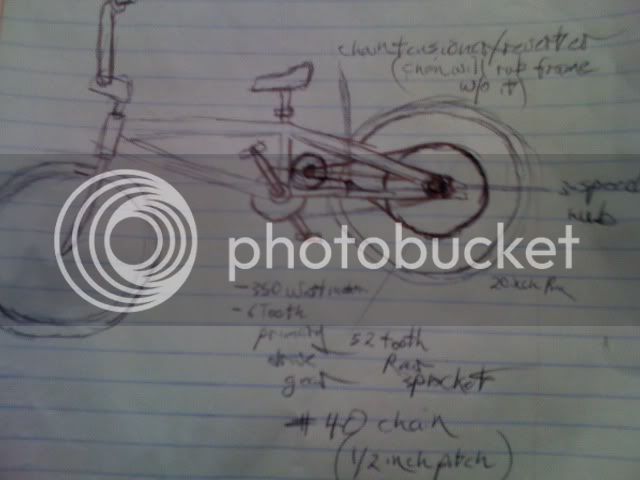

heres a rough mock up of what im thinking of how it can happen
hopefully you guys get an idea of everything and i can get it somewhat like that on a similar size frame.
what do you fellas from ES think of this. hopefully you guys will go easy on me since its my first e-bike build :)
I think this is a great project. I'm looking forward to the performance data. Don't feel bad about the motor being only 350W, the 3-speed trans (used as a jack-shaft) will be a big help, and the smaller motor should help you get very good range per battery size.
If you're open to suggestion, I wouldn't try a 16", I'd start with a 20" BMX-bike. You should be able to find one for $20 at a thrift store, or if you wait till the week after Christmas, you'll be able to find a dozen in the trash. Often when a kid gets a new bike, the old one gets tossed, or donated to a tax-deductable thrift store.
I've occasionally taken 2 free trash bikes and made one good one for a local kid, and once you start looking for them, you'll be suprised at how often you start to notice them. Also check the trash bin behind the local bike shop the day before trash pick-up.

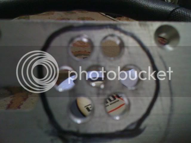

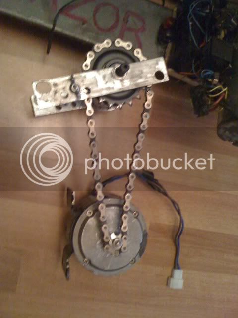

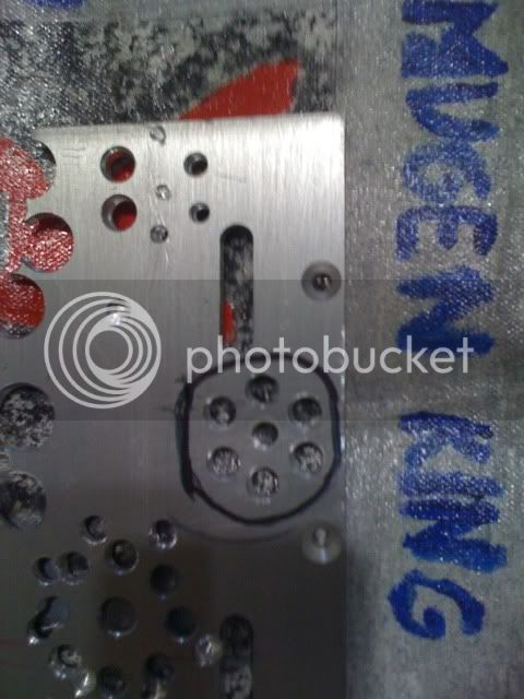

so ive decided to go with the chain drive system with the 3-speed hub as my jackshaft. i wanted to get the highest ratio possible. i had a 15tooth primary on the motor to an 18 tooth on the hub. from the hub there was a 21 tooth and that will go out to a 52tooth on the wheel, which will be 20 inches. that gives me an overall ratio of 2.97:1, which is good for about 50 mph, which a 350 watt motor cant handle. i cant find anything that will really gear me down to where i want, so i resorted to making my own.i decided to make a 6 tooth. it will take me down to a 7.42:1 gear reduction, which i would need with a low wattage motor. also ill have 3 gears to play with.
(queing the photo montage)
how it looks before i started anything. in its idea stage.

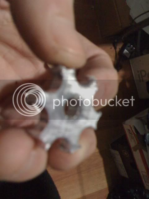

the "diamond" in the rough

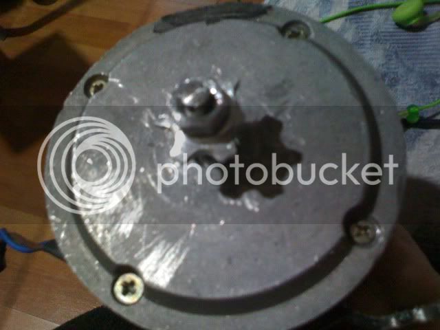

on the motor, ready to go.
i can see it coming together already.
Chordal motion may be +-20% of linear displacement.
But I admire anytime someone takes the challenge of making a part themselves. Good work!
Miles said:
Ref: http://chain-guide.com/basics/2-2-1-chordal-action.html
Ok ok, so 6t is more like 14% of linear displacement. I took a total blind guess at 20%, I think I did ok. ;)

update:
thanks for all the great comments guys.
so ive decided to use my bmx as my platform to build my ebike on now and i also decided to ditch the 3-speed hub for now and save it for another project. this is what i hope it will turn out looking like:
a sketch up of what i would like my bike to look like when i am finished(drive system-wise)

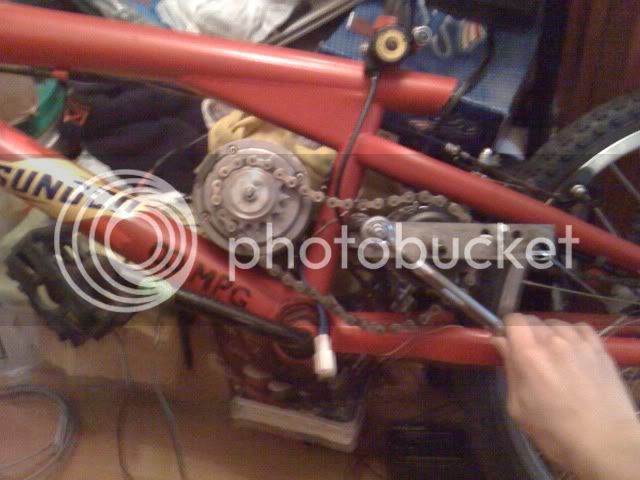

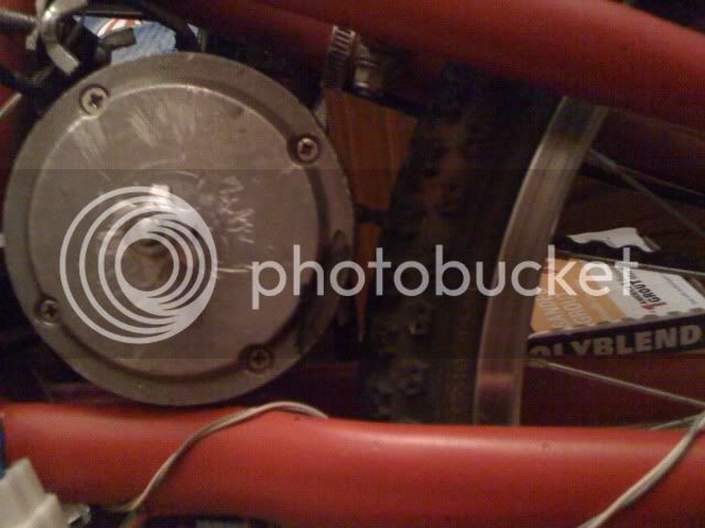

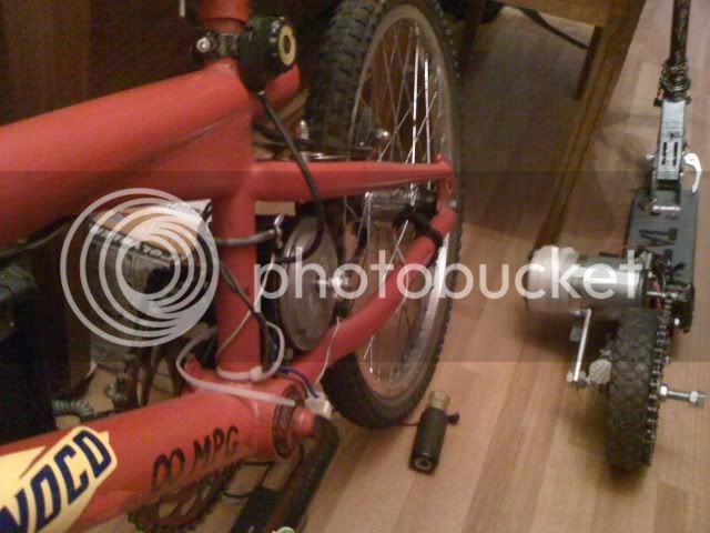

so here is what i have so far:
i want it as stealth as possible so i am trying to hide everything in the frame. dont mind the zip tie holding the motor on. that will be replaced with another u-bolt or something similar.
didnt realize how tight everything was until i mounted everything up and snapped the pic.
it looks like a straight shot to the rear wheel. still need to mount the rear sprocket up. that will be on it soon. the speedometer will be relocated of course because the rear sprocket will definitely be in the way. i think ill keep the 6 tooth primary on it for now and see how i like it when its running, and as you stated spinningmagnets, its more of a prototype/testing thing when i made it. also i was just seeing how far i can go with my abilities too; i always enjoy a challenge like that...lol with the 6 tooth primary and the 52 tooth rear sprocket, this will give me an overall ratio of 8.66:1 and will max out at a good 20 mph, which is what i was aiming for.

p.s.- the electric scooter thats in the background is running a homemade 6tooth aluminum sprocket and i so far holding up. but only time will tell if it will truly last...lol

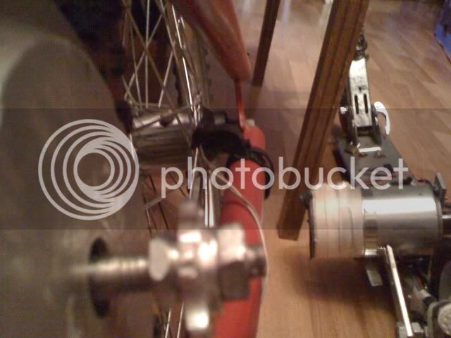

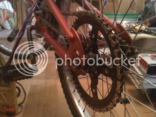

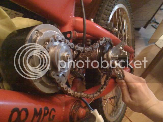

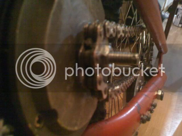

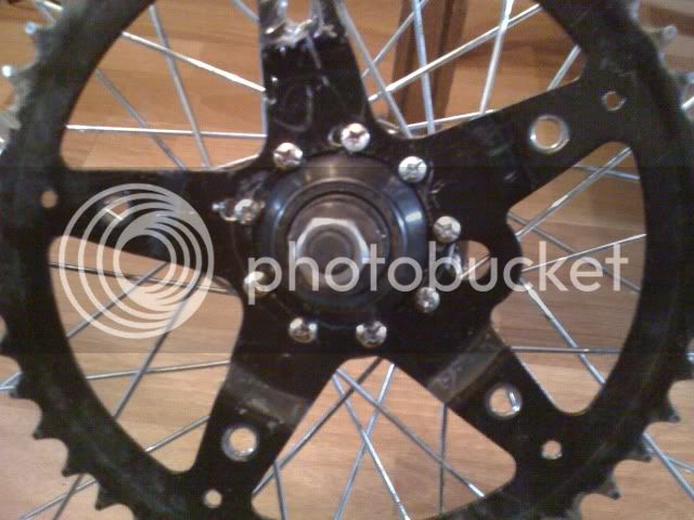

well enough of that. some more updates. so as i stated before i was gonna fit a 52 tooth chainring on the rear wheel but i still want my pedal function. i didnt have a hub that had the disc brake adapter, because if i IIRC, the 3-speed hub im using is from the 1980's. so my imagination got the best of me and i was in the eff'in zone. so after all said and done it came out looking like this:
now i have both drive sprockets for the pedals and motor.
chain is mounted and need to throw on a tensioner which will be soon.
i cant say its that stealth anymore. that 52tooth chainring is noticable to me from a mile away...lol

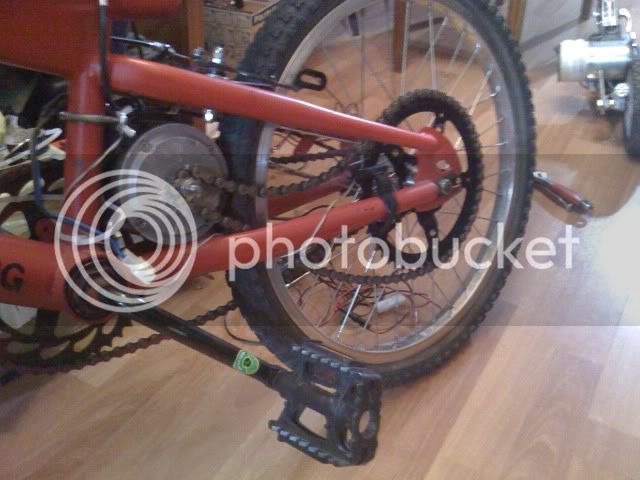

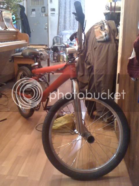

so i think i am close to completion. just a few more odds and ends to tie up and itll be good to go. i dont really feel like typing so ill post pics and explain on the way.
there it goes in its current state. cant find room on its frame so ill opt to carry the batteries in the bag(SLA's are heavy as hell).
another pic of it
the battery/tool bag

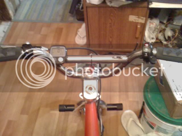

my "dashboard" so to speak. my speedometer, brakes, throttle control and my ornament in the middle.

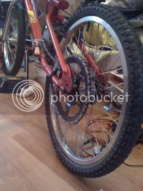

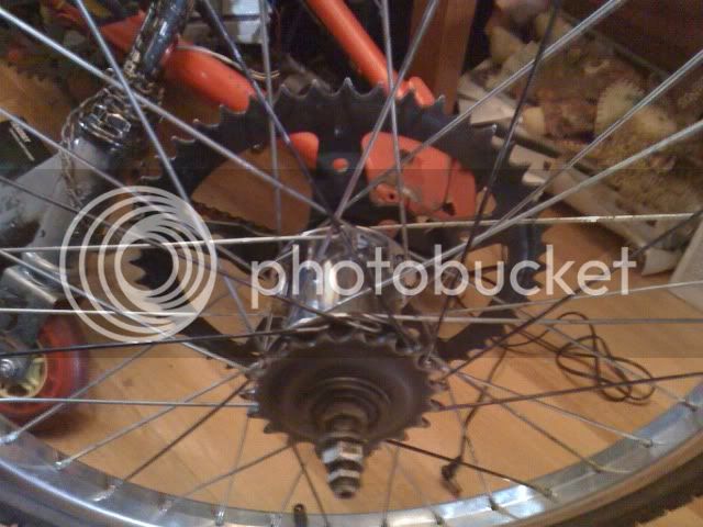

the rear wheel with the 52 tooth sprocket

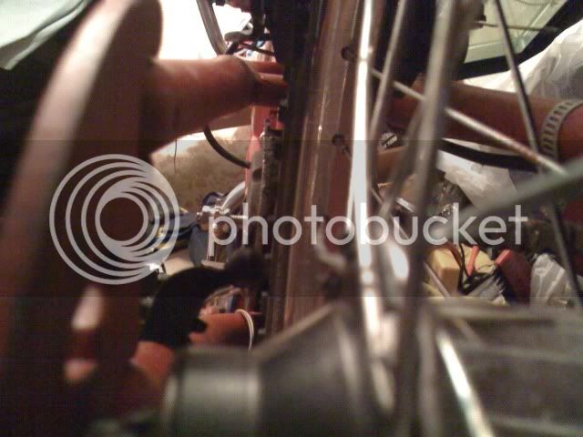

i decided to gear it up some so im switching to a 8 tooth front to give me a 6.5:1 gear ratio if i can recall correctly

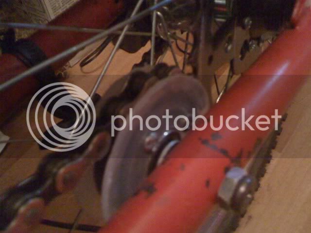

my homebrewed chain tension, well its more like a chain diverter so it doesnt hit the frame and fall off.
when i was testing to see if it worked, i noticed there is a lot of chain chatter. i guess it is the chain tensioner. but if i can get any input from other members on ES if they experience something similar with a similar setup like mines, please chime in.
not that i have any experience with that kind of setup but from experience with other chain driven machines id say try adding another chain wheel (or tensioner) as close as you can get to that small sprocket on the motor .
nice work by the way . ill be interested in seeing that unit move.
Thanks enoob. Any help is better than no help...lol. I do still have a slight amount of slack in the chain so I think I'll try that. The "tensioner" on it right now really only keeps it on track and in line. There is one thing I kind of want to try that I saw on a bike forum that could possibly help my problem is a "ghost ring" but I'm not sure if something like that can handle speed. I'm just waiting for a fairly good weathered day so I can get some testing runs it and see how this whole rig performs...lol.
so ive finally got around to getting a test run in for it to see what this thing can do and im pleased with what it has so far.
heres a vid of the test run i did.
[youtube]ST5XWbg0ux8[/youtube]
(vid is a little crappy because its from my cell phone, all i have at the moment)
it feels a bit sluggish but i guess its the wattage of the motor, which im thinking its a 250 watter now and not 350, 24 volts, and SLA's in cold weather.
it got a top speed of around 15-17 mph which felt pretty quick to me(ive never been on a bicycle moving that fast before). not sure if my bike computer was calibrated correctly but it seems consistent with the speed calculator that im using. so far im happy. im trying to push the limits of this thing during the initial testing period right now so i can work its bugs out so i can get it ready for the spring. did an awesome "burnout" on ice just to see it my drivetrain can take abuse, it was cool intil my batteries started giving in...lol
