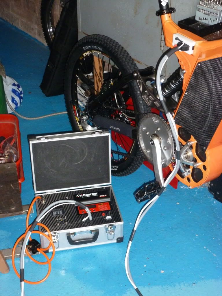

The little block in the side of the frame infront of the seat is my series/parralel changer, when this is in to ride the bike the 3 permanently parralelled pairs of 6s 8ah zippy's are connected in series for 18s 16ah, to charge the bike this is pulled out which seperates the pack into 3 parralelled pairs and isolates them from the controller. Another block on the end of my charge cable from the icharger 306b fits in which connects the 3 pairs of 6s packs all in parralel to charge as a 6s6p 25.2v 48ah pack. The icharger can still balance charge the 6p groups through the d-sub connector, it works well, what a brilliant charger these are!
pics here;
The icharger putting 16a into the pack, this was me just pushing my 350w power supply to over 440w just to see how good it was!! i dropped the icharger down to 12a to keep it safe but atleast i know it has some power in reserve.
and the packs being charged connected to my harness before it was installed into the bike;

PS: And FTW with that charger setup. Now you are just showing off ... Mad skillz there.
I knew you had something up your sleeve but did not know it would be this good. Congratulations it looks amazing.
Nice to see such fabrication skills. I hope to see a vid of this in action.
I love the charging solution, it looks very plug and play which I think is important for usability.
