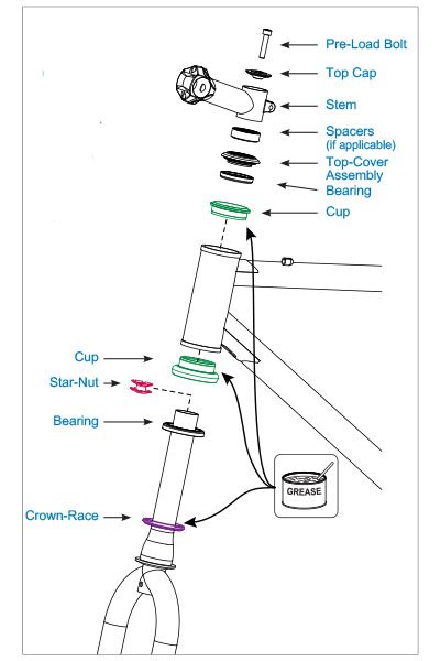

OK, you've just about convinced me to do a threaded to threadless conversion. I'm still a little confused on what happens at the upper end of the threadless fork. I mean, what specifically do I need to get to clamp the top of the fork to the frame, and how do the upper bearings stay put? I probably need a picture of what it all looks like....I'm trying!
The stem clamps down to hold everything in place. The top cap sets the bearing preload. It's a superior system in every way except easy height adjustability.
