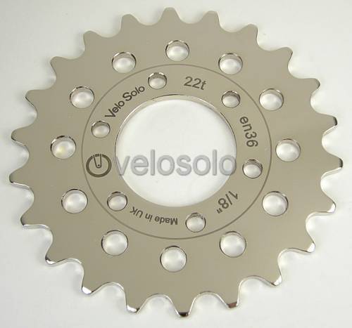

http://www.velosolo.co.uk/disccog.html
they go all the way up to 22t which would be my choice.
these could even be used on the disc brake side or offer ways for adapters to interface with a big foot on shimano styled splines.

I just bought
http://www.ebay.com/itm/Single-speed-cog-fix-disc-hub-Teeth-16T-FOURIERS-Logo-/161775917695?hash=item25aa989a7f
3/32" isnt what I really want so will get the 1/2 x 1/8 velo gear cog and I hope it still fits. Might be to wide? Anyway I am hoping that a few of these together might be stronger however I think it is not ideal as those shimano hub style splines are all on a slant so I dont understand how it all would piece together without any play.

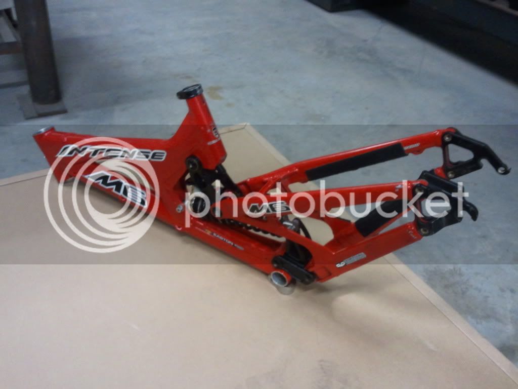

My dilema is DH bikes pivot area clearance, and then rear 150mm axles are rare to find parts for customizing a tough freewheeling system. If I stay with 135 white industries products will be my first choice.
But I am pretty dam sure I want maximum DH experience with this bike well up to entry level $ prices.
Option 1 is brand new glory 2 = all is new, fork low end spec but easier maitenance $2k - big S bend is not ideal requiring a longer bb and torque arm more than if shorter.
second hand options = must be nearish to my house as I'd only ever buy in person after seeing and playing with the bike.
bikes with beautiful straight lines on top and bottom for battery tray and motor mounting
2. $800 cheap old - but really simple pivot and totally out the way of bb area and might make a really easy short torque brace point. possibly old clapped out bike.
http://www.gumtree.com.au/s-view-details.html?adId=1085567510 It's a long bloody drive to go look.
3. $2k couple of years old - I need to see in person if the pivot/swing arm is inbound of the end of the bb shell. that frame new is rrp 3k so second hand if in great condition is worth the 2k alone. closish to home.
http://www.gumtree.com.au/s-ad/indooroopilly/bicycles/morewood-makulu-downhill-bike/1085682977
4. $1.5k intense m6 - dont know why but just love that frame. pivots look complex though - this isn't the bike but shows the frame and not sure if the pivot is inbound of the bb shell http://s700.photobucket.com/user/erikkellison/media/July%201012/IntenseM6LargeStealthBlackFrame01.jpg.html or http://s204.photobucket.com/user/safetysam87/media/bicycles/2011-07-05074847.jpg.html yes it looks like the bb shell is past the swing arm
http://www.rotorburn.com/forums/showthread.php?293993-intense-m6-(medium)
then there are bikes with big s bends but battery room
http://www.rotorburn.com/forums/showthread.php?288678-Kona-Supreme-Operator-Large-1900
Hey mate
I wished you were looking in May Thredbo sold all there 2013 Glorys for $1200 fully taped up frames and serviced my mate got one ite v2 but cheap bike.
Check out Jindabyne notice board on FB people get tight for $$$ at the end of winter
I can go and check for you if you see anything :D
Cheers Kiwi
Thanks Kiwi but hoping to buy local so I can personally check it as well shipping and handing cash to strangers.
Rotor burn is pissing me off! they aren't posting my messages or replies even though I have trading access............
I really want the m6, its just a plain sexy bike.
EDIT
Just spotted an m6 on gumtree fingers crossed! big long drive to check it out but Ill do it as its cheaper.
http://www.gumtree.com.au/s-ad/yandina/bicycles/2010-intense-cycles-m6-fro-medium-downhill-bike/1083447314
M6 gets my vote. Those rear dropouts are gold for replacing with plates.
