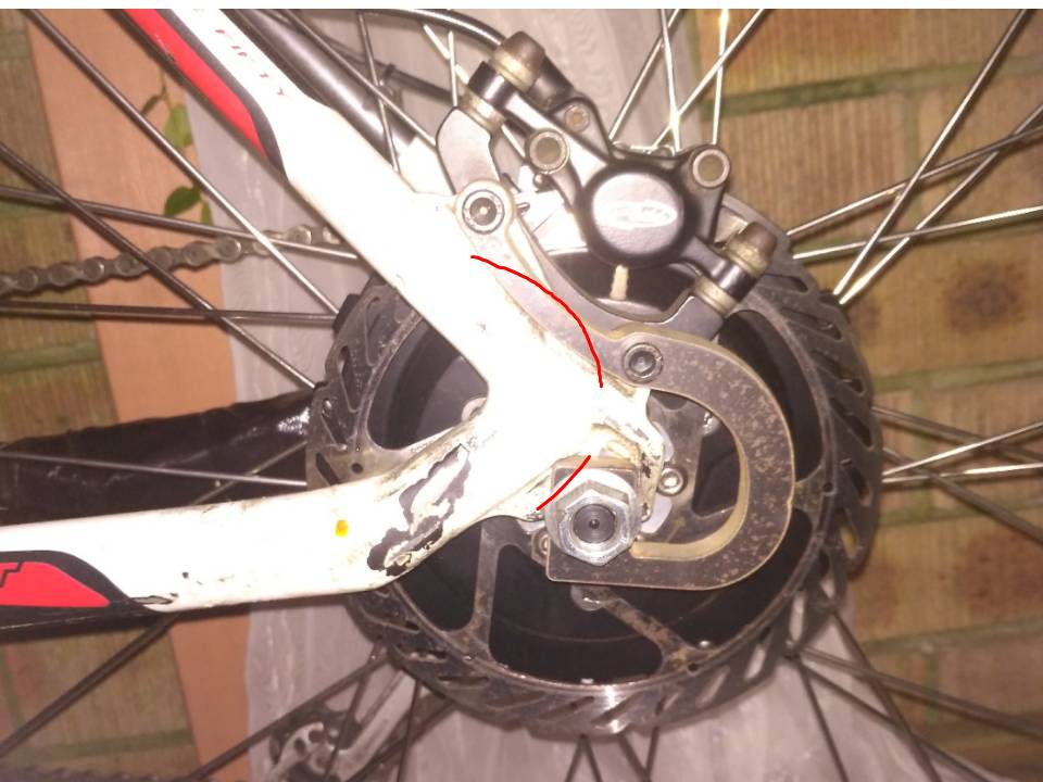

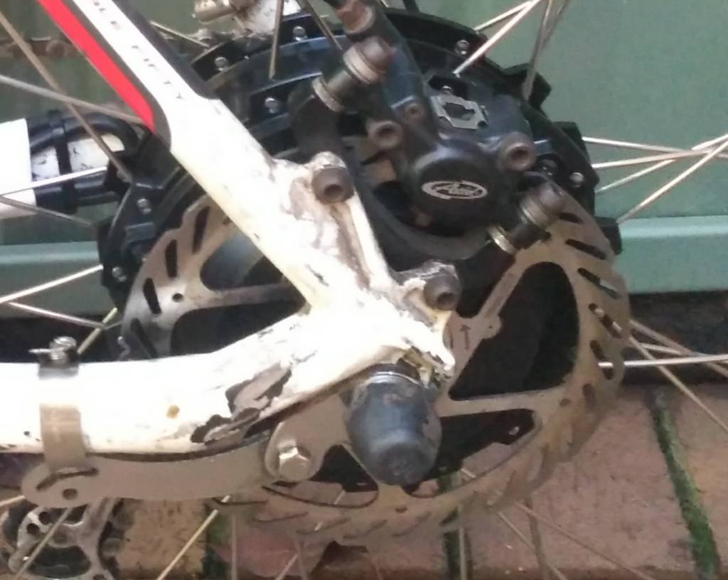

The torque arm has arrived and I've boosted power output!
Using this torque arm https://endless-sphere.com/forums/viewtopic.php?t=49635 I am a touch worried about engagement between the axle and nut. I only have enough axle length for 3/4 of the nut, with the only things on that side of the hub being 1 washer, the torque arm and the nut itself. Granted this is a quite wide torque arm but I think the shafts should have a bit more length from Bafang, my older SWXH had the same issues as well, I even stripped the threads slightly on the crank side.
Now running 30 amp + 60 phase amp on 20s LiPo. From a standstill or low speed the front end will get squirrelly / lift off. I think this is the most I will be able to get out of a 6 FET 4110 controller.
Once up to speed I'll sit at about 55km/h (on a 26" rim), using around 1kw constant. It would be good to increase this just for main roads sake with some extra voltage or a controller that can field weaken. The controller I have does not seem to have any issues running it even at top speed, so I think the stator design probably is not much of a reluctance design, despite being IPM. Maybe I would only notice this with field weakening though.
Even at this increased power I am shocked how silent the G360 is.
I am slightly concerned I'll strip gears, but I have a spare set so we will see. Does anyone know what torque / phase amps Macs or Bafang BPMs etc strip at? I'm trying to work out a safe level to run at, using the motor sim I would be at around 65nm now I think, which is above the 50nm rating Bafang gives.
hm, try a grin tech torque arm if it's thinner?
Nobody knows what the G360 will take, you're the first test hamster :thumb:
The grin tech ones don't fit my dropouts unfortunately, mine are too "3D". I had v1 clones on originally but they had to face the wrong way so I don't think it would be doing much. Even the new one I had to grind out to fit around some welds.
I've had issues like that and had to get tricky with spacers and other bits and pieces.
I always use grin tech torque arms as a base because they are the most snug. I have bought a dozen other brands over the years and it was a real waste of cash as they all had 0.5 - 1mm of play..

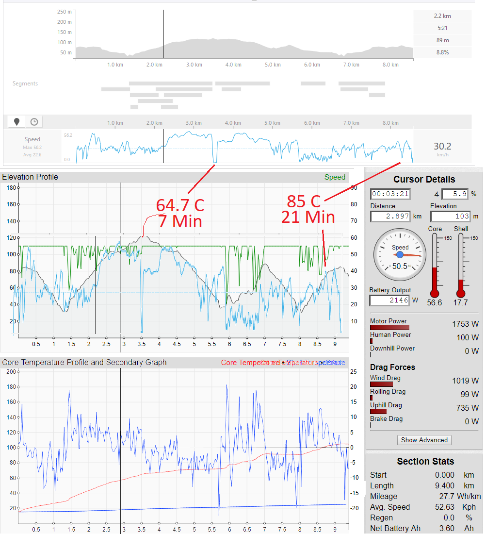

Jusin has the G360 on the sim now, (Thanks Justin, all of your simulators are so helpful!) sim-ing it puts me puts me halfway between a tuck and upright on the motor sim for reference.
I plotted a ride out the other day
It's a bit of a mess, data is out of Strava visualised over the trip sim of the same route. Trip sim obviously isn't the most accurate representation of real life, as it uses full power where it could not be used in real life etc, but from a temperature perspective it's pretty spot on in this regard.
Top graph I have plotted real speed over the top of simulated speed.
I've combined bottom graph to show both Grade and Shell temp.
After a 2km 4% average grade segment at full power core temp got to 65 C, pretty much bang on the sim.
By the end of the ride I had hit 85 C and started throttling. There was a 1 km segment at 10km/h average speed almost purely on motor power (super tough terrain) which didn't help with temperatures.
Overall ride time was 21 minutes. Despite the core being hot, the cover felt no hotter than at the beginning of the ride. From here the motor definitely needs an oil fill to help increase thermal conductivity.
