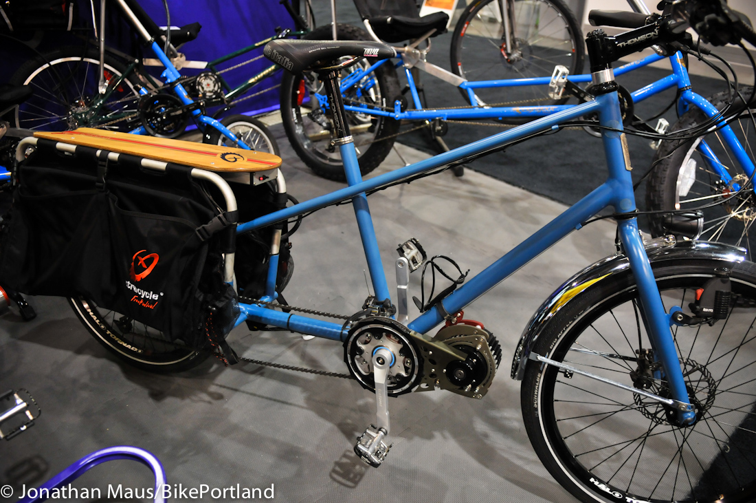

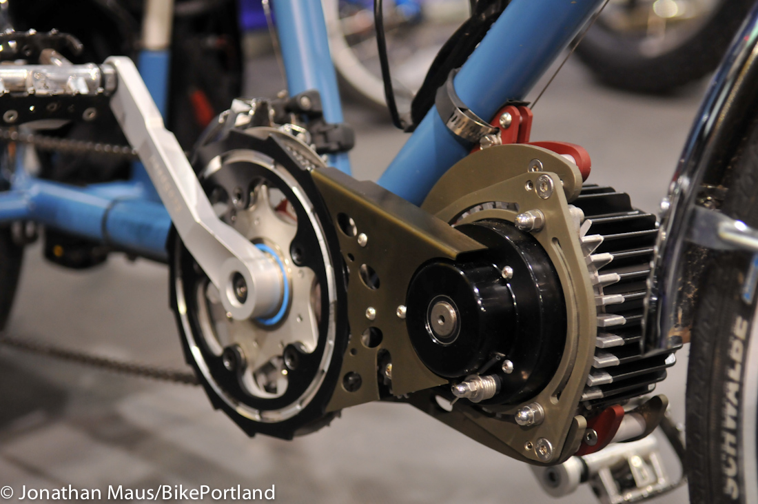

Someone from EcoSpeed sales got back, and apparently they're coming out with a new refresh for their motors, and had a nice picture of a better configured bike, with motor, with batteries in the saddle bags...
I wish he had just given liks to the installation PDFs, but what the heck. Basically, you remove your 'old' cranks, put this crank in, in their place, tighten it up snug & secure it, etc., route the wires, mount the controller, hook up the batteries, and try not to lose any fingers.
Anyway, here's what I like about the pedal configuration:
  • It gets the mechanical advantage of all the bike's gearing.
  • The casing on that motor looks like it has some heat dissipation designed in.
  • If a tire goes flat, I am not dinking with wiring.
  • If the rim gets bent, or a spoke broken, it's just a regular wheel.
And here's what I don't like:
  • Superman is pedaling my bike. I don't know if the stock chain will take it.
  • If it DOES break, I wonder if that chain will snap up and hit my leg? If the motor is cranking away, there'll be no stopping it in time. It makes me think about a chain guard. Maybe something like this, I guess: http://www.amazon.com/SKS-Chainboard-Bicycle-Chainguard-System/dp/B002I7IBPE (except one that 'fits')
  • A second, little chain from the motor to the crank, to go wrong, too.
  • Yegawds! The price is a bit steep. There's no denying the sticker shock on this.
  • +$400, if you want to keep the front derailleur sprockets (so not quite ALL of your bike's gearing). I guess the motor needs a longer armature to reach past, and extra torque on everything, and the sprocket is probably 'special' somehow, too... but that just makes the sticker shock worse.
