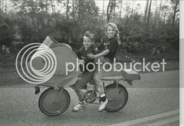

Hello everyone,
I just joined this forum. I wanted to reply to the post from May 4th, in which username 10kw posted a picture of one of my faired bikes.
I have been building fairings since 1986.
NFA Vehicles Type 5:
This bike's fairing is made of Kevlar. I used this bike while I was in the "shore patrol", the Navy's Military Police. This bike can float, so it is "amphibious". Here it is in plain gray Navy paint, with my Daughter giving her friend a ride:
Here is the Type 6, which has the same basic fairing as the Type 5, with a tailbox and a roof:
Type 7 is a complete re-design. The girls designed this fairing, with a lid that opens , hinged at the front. I found the best aerodynamic effect was with the top set at 53 degrees:
Here is Type 7 with the 'hood' open to 90 deg. It's nice to be able to use it as an airbrake:
Here is the mounting bracket for the Type 7:
Here is the Type 9:
Mellisa designed this bike with a spoiler based on the Kenworth truck. The previous Type 5 had such a big fairing that , when it was used in Florida, the test riders complained that it was too hot.
So the Types 7&9 have smaller fairings.
