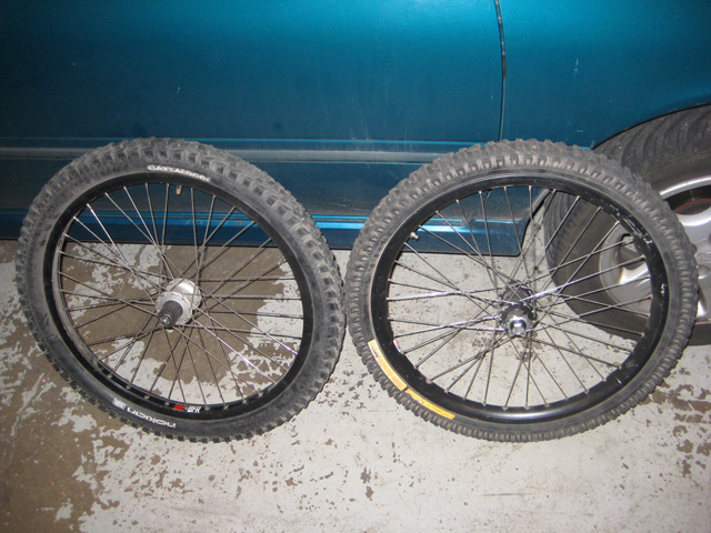

Well, what are the chances; 4 threads ( 2 on this forum ) asking for burnt out hub motor wheels to use as chaindrive wheels.. hours spent at bike shops.. days spent speccing out how to build a tough wheel from scratch on a budget.. and no dice.
And these two 24" downhill wheels, with what look like 13ga spokes, and 2.6" tires just fall into my lap for $20 each at the Salt Lake City bicycle collective:
Bought both just in case.. :lol:
So i am out of gridlock and the bike is partially together:
26" x 1.95" in front, 24" x 2.6" in back.. 203mm front disc, no rear brake ( regen will do that job! ), and a surly 1x1 fork..
The thing handles like a friggin' bus and will hopefully be wheelie-proof with the motenergy motor :]

I think you might need a bigger rear tyre, i would be 100% concerned using a normal bicycle tyre on the back of my bike
can you imagine accelerating hard to 40 mph 50mph, expecting nothing but awesomeness and then your rear tyre has all the sudden disappeared and your heart is racing because you can hear nothing but your rim bashing the ground, left with strong rear regen and now useless lol
but all the same i am tempted to purposely blow out the cheapest bmx tyre i can find
look at the size difference with these wheels,
you have the magic pie with 26 inch size rim, and then a 14inch motor bike wheel.

Yeah i get your concern about the tires. I wonder if there is a motorcycle tire that can be mounted on a 24" rim though.
If a 16" motorcycle tire goes on a 20" bmx rim, maybe then a 20" or 19" motorcycle tire goes on a 24" rim? I suppose i'll have to hobble over to a motorcycle shop and see if that's the case.
If so, oh man, that would be sweet :]
