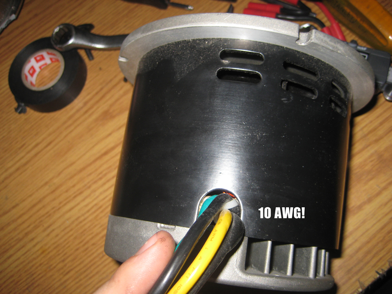

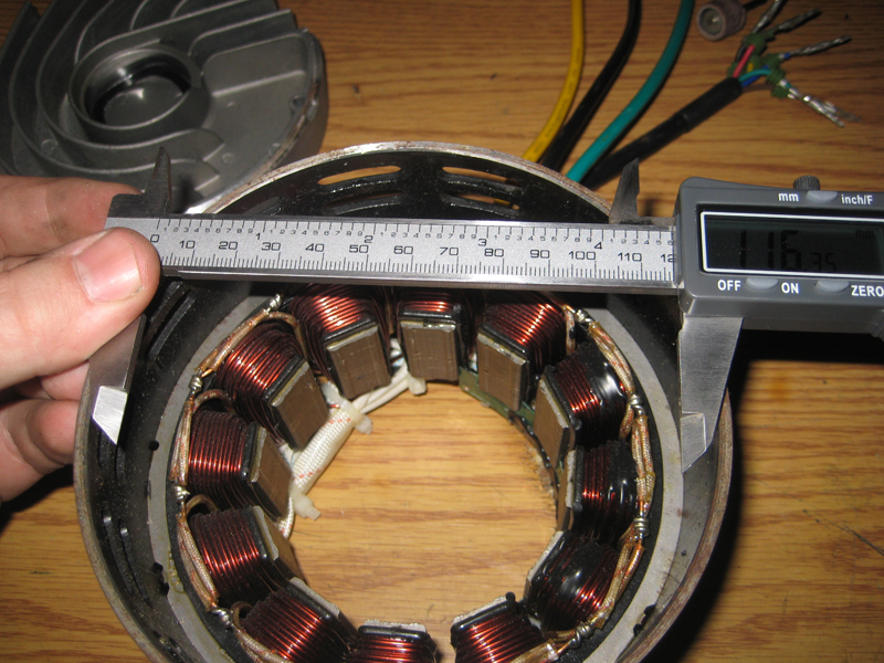

The transmagnetics motor is here.. and of course, i had to pull it apart as soon as i got it :D
The stator + magnet assy are awfully dinky in real life, taking up about half of the space internally, the rest of the space being the intake and exhaust.
This is kinda like a large RC motor wound down to 70-75kv? haven't fired it up yet.. will get a more exact kv later.
Efficiency apparently peaks in the 92% zone? holy smokes.. i dunno how that works out. The windings are super tight and precise on this motor, but the laminations are just 0.5mm. Low pole count, plus a really wide stator may be the ticket, i dunno.
Just a hair shy of 11lbs.. that's 2 pounds heavier than the MAC motor and it can output about 1kW continuous more when both are on 48v, even at 85%. But with the cooling scheme of the MAC VS this, guess which one can sustain that longer ;)
I bet this motor is really happy on 72v :mrgreen: :mrgreen: :mrgreen:

Thanks for the motor porn. I didn't have the heart to take mine apart. Looks like there is plenty of room to rewind with more copper if you are so inclined
+1 - excellent motorpr0n!
I like how they gave some thought to air cooling. Can't wait to hear what you find about the performance...
Ya, kinda makes me want to shaft mount a fan onto my MAC motor first to see how it does with real cooling.
