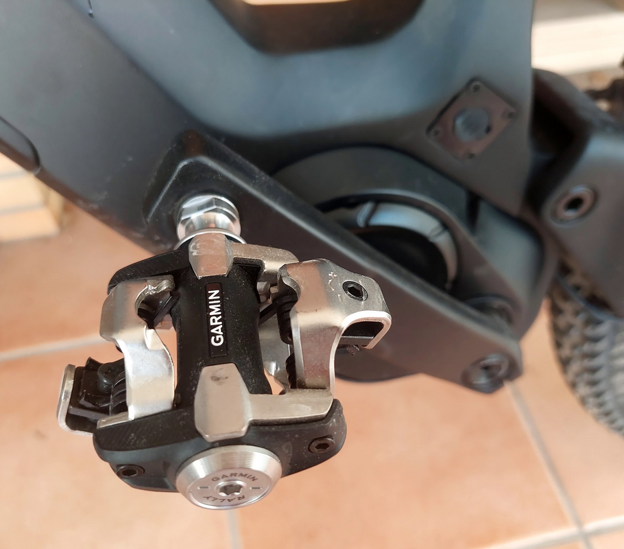

I did first test ride with the Garmin Rally XC200 power meter pedals + Garmin Edge 1040. On the EasyDIY display, I have the regular 3 buttons and I also have the 4th button specifically to change the Garmin Edge pages.
The EasyDIY display is very small, shows only motor data and is hard to see outdoors. But since this display is implementing ANT+LEV Ebike, I am seeing the motor assist level value and battery SOC directly on Garmin Edge, which is showing important data as seen on the image: my human pedal power; my heart rate; my stamina; etc. There are other pages that I am not showing, like the map navigation page, elevation graph page, etc.
The pedal power meter seems to work very well, no issue at all for being installed on an EBike. And I was also using my Garmin Fenix 7 watch, where I also paired the pedals power meter, meaning I was receiving and recording the same value both on my watch and on the GPS cycling computer. This is the advantage of ANT compared to Bluetooth.
