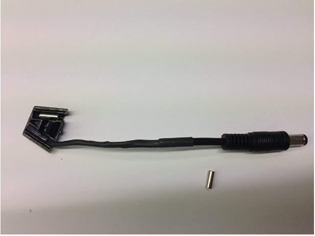

There are two Versions, one the opens a contact while braking and the other Closes the contact while braking. The contact is inside the parted brake levers. The contact "happens" before the braking force which is good for regenerative braking.
As a simple or interim solution you can buy reed contacts and a small magnet and glue both to your brakes. This is how usual brakes are modified for a BionX upgrade for example.
I think mine is the higo opener switch?
If I press the switch then it doesn’t cut the motor
If it’s in its retracted position the motor cut is enabled
