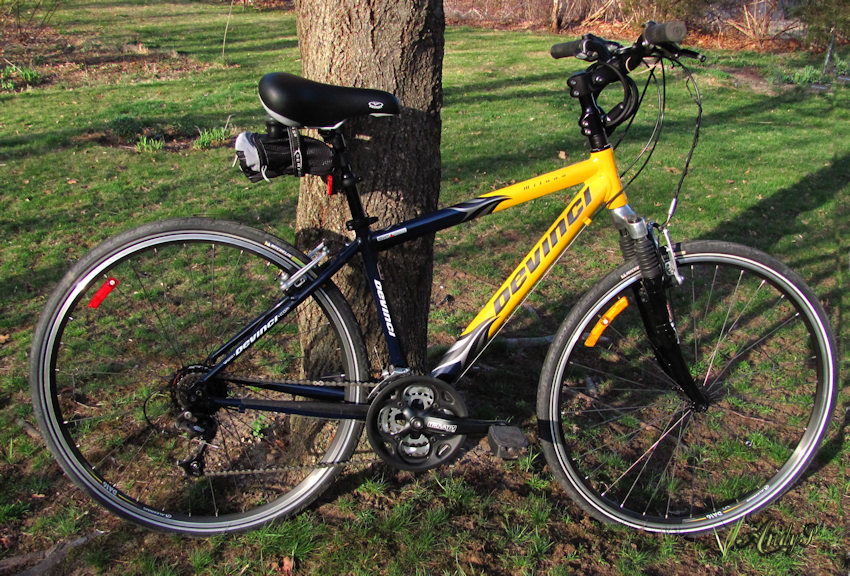

Hi there, this is my first post, although I've read dozens of threads already. I'm obsessed with electric bikes so I think I will fit right in here. I think about them day and night, although I've never ridden one before. My friend recently bought a 72V 20Ah Daymak scooter for $1599 ($1960 total) that will do 75km. I test-rode it, the acceleration is scary fast - and that's a 230lbs bike. So I've decided it's time to pull the trigger.
I used to ride this DeVinci Milano. I could easily maintain 25km/h on flat ground with this bike, while barely touching the pedals. The frame broke and it's gone now.

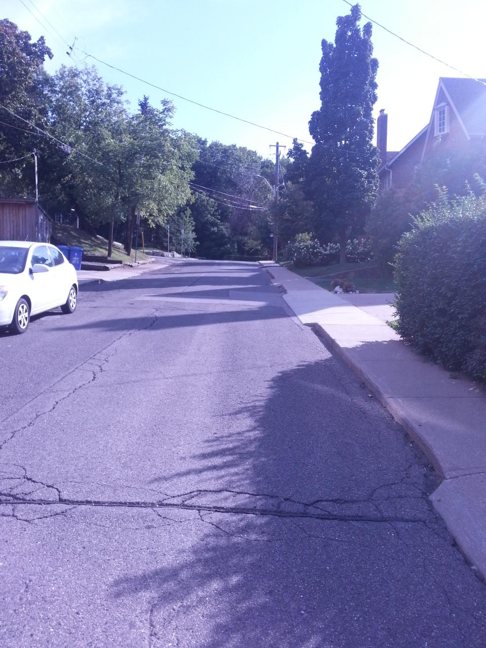

Here's the view from my house. I live on a steep hill. I'm also at the bottom of the Niagara Escarpment in Hamilton, ON, so I need to be able to shoot up the steep incline at reaosnable speed every day without making my ebike sad.

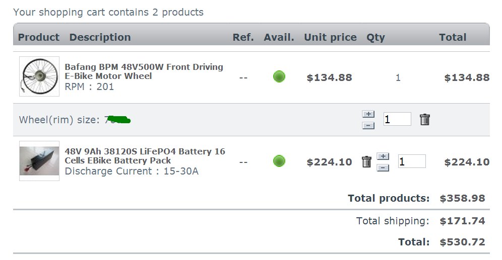

The short-term goal is just to add a basic conversion kit to my existing bike. Money is tight right now. This is what I came up with so far:
http://i.imgur.com/MOtWhCL.jpg
Thoughts?

That's a lot of torque to put through the front wheel. I think you'd be better with a rear wheel motor.
You should get the upgraded BMS 30 to 60 amps because the controller can be as high as 32 amps, depending which one you get.
Additionally, you should get a pair of their torque arms, and if you want to keep your existing brake levers, a pair of their hidden wire brake sensors. The sensors are essential if you get a bike with integrated levers/gear-changers.
That looks to me like a lot more hill that a little gearmotor can handle.

Mid drive + hub motor is not that bad an idea. But I'd still not recommend that bafang to get up hills that steep. Maybe a GNG kit, plus a bigger hubmotor though. You can do mid drive and a rear hubmotor.
Hills are going to be a killer. That little motor isn't going to live long trying to haul someone your size up those hills. A Crystalyte HS3540 in a 20" wheel would do it.
As for range, on flat ground, you need a battery sized at 36 watts per mile at 20mph. That battery you chose has 432 watts (48v X 9ah =432 watts). that works out to a range of roughly 20km. Add hills or more speed, and that will drop considerably. So considering your need for 140km range, you would need to find a way to strap 7 of those batteries to a bike frame.
The 48v 500w 201 rpm BPM with a 30 amp controller will drag you up that hill OK. It's a superb climber. I'm not to sure why the others are saying it wouldn't. I'm 100kg and I run mine at 36v. It gets me up a 30% grade with a bit of pedalling, and mine's a code 13, which isn't as efficient as the one you chose. Perhaps they can clarify why they say that. Be aware though that its top speed will only be 17mph on a flat road.
The slow motor would do better than the fast version. I totally agree with that.
Fortunately, if that's the entire hill in the picture, it's very short. So it should not overheat before you get to the top. I just couldn't say if it could climb it at all. Looks even steeper than 30% to me.
But I'm fairly sure that a larger motor given the same volts and amps would climb it better, especially if it's also a slow rpm motor.
I'm not very comfy recommending 1500w into the smaller gearmotors, but I know others have done it with the larger ones, like bmc or mac. Am I just confused and misinformed? How big is the BPM. is it similar to the mac?
Dogman, I think you and the others were getting the BPM confused with the smaller Bafang SWX motors. It's a large geared motor like the MAC. It can go to 2KW for short periods - maybe even higher. I've run one at 64v and 30amps.
Thank you for the dope slap. I need them from time to time.
201 BPM should work as good as the other stuff I suggested. The hill is short enough to flog hell out of that motor without killing it. I just misunderstood and thought it was the small motor.
I try, but it's hard to keep all the info on all the motors available straight in what's left of my brain. I have some experience with tiny gearmotors, and lots of experience with dd hubmotors.
Where the OP lives, he won't have the climate problem I have. Here in the southwest deserts, gearmotors cool too slow during the summer to be good for me.
So go for it, and give it at least 48v 30 amps. That's 1500w. Cruising at 25 mph on the flat though, you will only use about 800w, and that won't damage the motor.

The motor is rated at 500W. Could you quickly explain how this works? I am guessing the motor just draws more current under a high load.
Using a bicycle power calculator, I got a figure of 1900 watts for a 25% grade at 10mph.
I live at the bottom of a ~300ft escarpment which divides two halves of the city of Hamilton. This means I need to be able to get up and down every day, multiple times a day without worrying about the motor burning out. The main function of the electric motor will be to tackle these slopes. All I want is 6-10mph here.
According to http://www.electricbikerange.info/ and Google Maps, the mountain accesses by my house are roughly 6% (80m/1400m) and 7% (66m/900m) so that's really not too bad. The hill to my house is about 12% (14m/120m). So I am guessing I will be OK.
It means that you can run at 500w all day and it won't overheat. It can go to 2kw or more but not for a long time. That hill is not long enough to raise the temperature significantly.
The motor will draw about as much as you give it. It's the controller that limits the current. I ran one at 40 amps and it didn't complain.

It's not hard to get up 12% grades reliably. You just need a slower winding motor that can periodically handle 1200-1500w. You will slow to less than 10 mph on that hill to your house, but a slower winding motor will handle it fine for the short duration of that climb.
Legal stuff is your own problem, but one nice thing about the slowest windings is that you don't stick out like a scofflaw on a bike with a 20 mph top speed. Ride 35 mph and you do.
Any of the motors we previously talked about will work for the ride. They won't be fazed much by any of the hills that are less than 10%. Even in 26" wheels you will be fine.
That photo just looked steeper than 15% to me.
