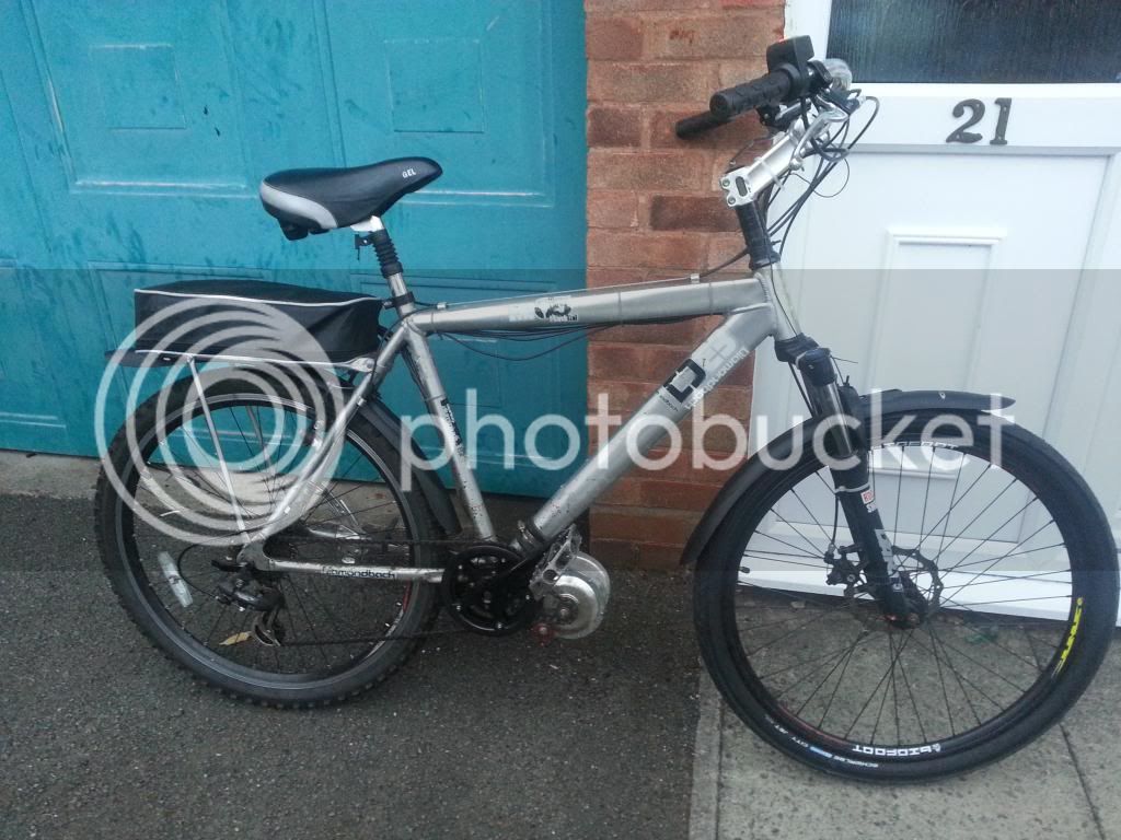

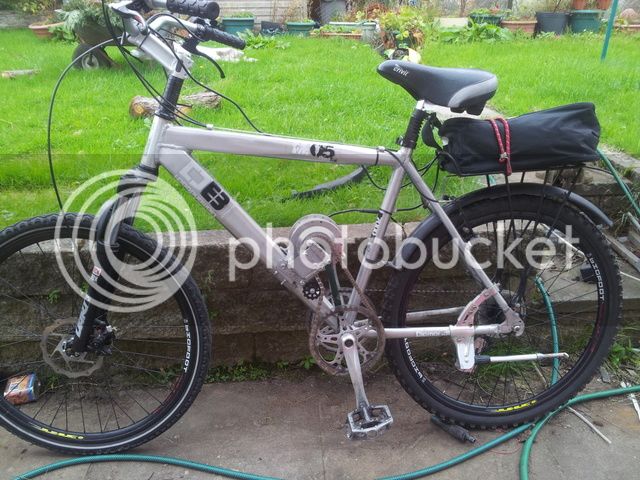

d8veh said:

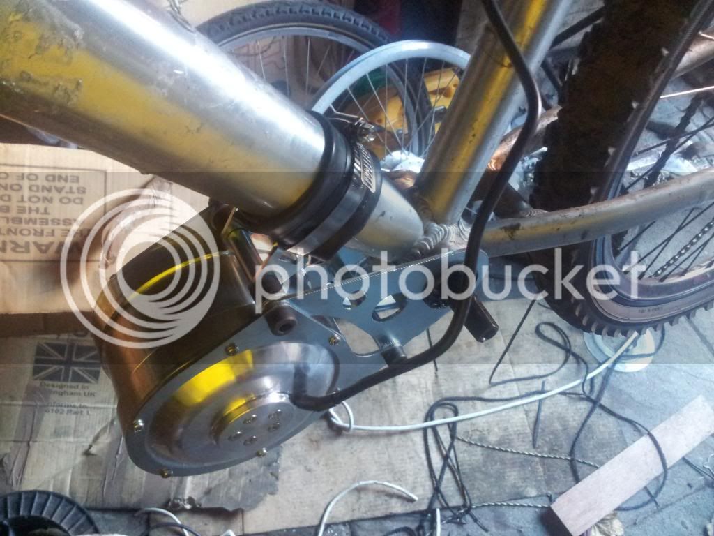

Here's mine. I built it before crank-drive kits like Bafang and GNG were available:
Hi d8veh. I spotted your ride in The Mid Drive Hub Motor Media Group section. Is that a "geared freewheel" front hub motor mounted in that triangle? What can you say about the riding experience when the power is turned off? Please tell me about your ride. What do you like/dislike about it? You built my idea over 4 years ago. Nice!
I only did it as an experiment to test efficiency and climbing power. It has a free-wheel in the motor, but not a freewheeling crank, so the pedals go round with the motor, which is a bit weird at first. The motor doesn't turn when you pedal it though. If I did it again, I'd use a front Q100 or Q128 because they have easily reversible clutches, which means you can flip them round to get a motor with a narrow axle and you can fix a sprocket on the right side disk mounting holes. Then you can use a normal free-wheeling crank from Cyclone.

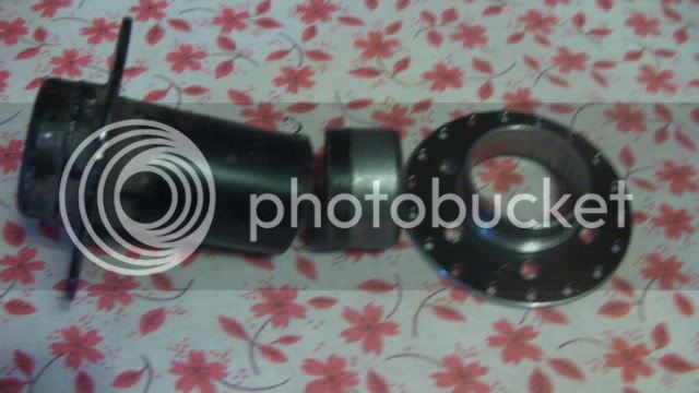

I made a freewheel sprocket fixing by cutting a steel BMX hub in half, though it didn't need to be a freewheel because there's one in the motor. O could have just used a sprocket and a spacer from a cassette, drilled with 6 holes:
Good to know! I originally had my eye on the Q100H 350W/36V, but the wiring out the axle wasn't ideal.

Although not a hub motor, the small light geared MY1018 brush motor (similar to pictured above) can run both ways too. That is the setup I'm leaning towards for strickly climb assist only.
