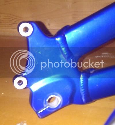

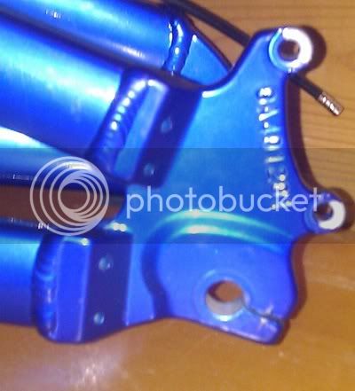

OK.. As the motor makes it's way to my doorstep, I'm starting to look more seriously at the dropouts. The width between the dropouts are 138mm , not 135. I can easiy pull them to 142mm without exessive force. there is also a about 2mm wich could be removed inside the left dropout if needed ( but do I want the wheel closer to the disk brake?).
The big problem with the dropouts is the 12mm clamped axle hole. I'm looking at two options: Either glueing the clamp gap with scotchweld DP , and cut a 12mm vertical dropout. Then glue a 1mm steel sheet around the inside of the dropout. Or just cut off the clamp , and let the torque-plates take the full load.

I've noticed the dropouts , it's actually a 12x135mm maxle, only the 2005 model and replacement swingarms are 12x150mm.
It's the same design as the 20mm front maxle.
I'm not shure what I'll do with the dropouts.
This one http://endless-sphere.com/forums/viewtopic.php?f=6&t=15439 has welded dropouts.
Doc's DH-comp has custom made plates with dropouts glued(!) to the swingarm.http://endless-sphere.com/forums/viewtopic.php?f=3&t=18473&start=60
I would like to have clamping dropouts , so I guess I'll have to get two plates machined.
The left side is easy , just mill down the elevated area on the outside and put a steel plate on the outside. the right side however..

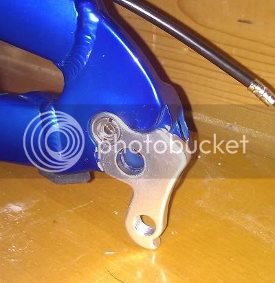

@drbass: I guess that design is for the 150mm 2005 swingarm. I got the 135mm swingarm , and will not have space for any plates on the inside of the dropout.
No , I'm gonna mill down the bump outside the left dropout , to make it completely flat. The right one will get milled down a bit , but I can't remove the whole bump because of the gear hanger.

I have also the 135mm but i would have need the 150 when i assembled my hub motor due to my disk brake adaptor.
I bended the swing arm with hydraulic equipment and take care of not stressing the welded joints. it work like a charm!
Doc
@ doc: No bending the frame for me. I got the torque-plate design pretty much nailed. Only thing i struggle to decide on is if I'll make removable torque-plates with axle holes , or open dropout plates wich I can glue to the frame..
