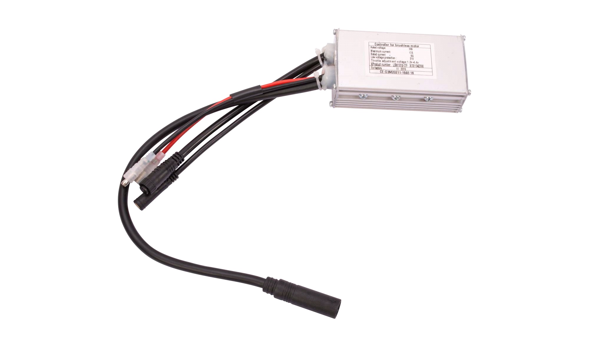

My Benelli e-Misano has a cadence-only PAS. I want to upgrade it to a torque sensor. The bike doesn't have a throttle, uses the Lishui LSW1010-17F controller and the Bafang C965 lcd display.

  • can I plug a torque/cadence sensor (e.g. ERider T-17) into my LSW1010-17F controller? Maybe by soldering in some extra wiring?
  • if yes, do I have to (or ought to) flash the open source firmware?
Yes, this will work. You have to solder the wire for the torque signal to 'SP' or 'AD1' on the PCB.
The T17 works with 5V, but I'm not sure if the 5V output of the PAS connector is sufficient for driving the torquesensor. Maybe it is safer to use the 12V from the half bridge drivers as power supply for the torquesensor.
Costs except the sensor: <10$ ;)
regards
stancecoke
Perfect, thank you @stancecoke! Will order the T17, give it a try and report here. But what do you mean by 'safer'? Am I right that 5V can't harm the TS and I can switch to 12V later if needed? Or better to not even try?
Am I right that I don't have to re-flash the firmware to run the TS, but if I do it will give me additional possibilities to customize the controller behaviour?
Another question is about the T17's axle length -- it's 150mm minimum whereas mine is currently about 130 mm. Will it change the chainline? Or the chainring spider will compensate it?
sure you have to flash the EBiCS firmware. The original firmware will not support the torquesensor mode.
no, but the sensor might draw too much current and the 5V rail will drop voltage too much. The the whole system will get unstable. We had issues with additional power consumers on the 5V supply.
