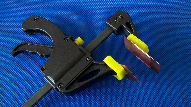

As always, I've tested with ZKETECH EBC-A20 and a self-made battery holder. It's a PC-connected battery tester supporting 4-wire measuring and discharging at up to 20A.
I've slightly upgraded my battery holder - i've replaced one of the terminal pads with a larger one and now i'm calling this "holder v2.5"

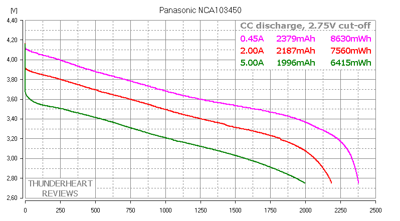

Panasonic NCA103450
This cell is marked Panasonic 6402 C NCA103450 6323W2W8B.
The main specs from its datasheet:
Rated capacity: 2200mAh at 0.44A discharge at 20ºC
Minimum capacity: 2270mAh at 0.454A / 25ºC
Typical capacity: 2350mAh
Nominal voltage: 3.6V
Max continuous discharge current: 4.54A (i've tested at 5A)
Discharge end voltage: 2.75V
Std charging current: 1.589A
Charge end voltage: 4.20V
Test results:
Great results at all three discharge rates. Look at the curve at 5A - it's almost linear. Maybe it could handle higher current but i think you'd better not to discharge it at >5A.
