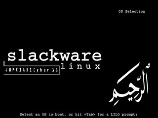

Am I the only one who was thinking of something like this?
Looks like these guys still haven't switched to grub. Oh well, it's a pretty small operation; to be expected, I guess.
Mmmm, not really.
