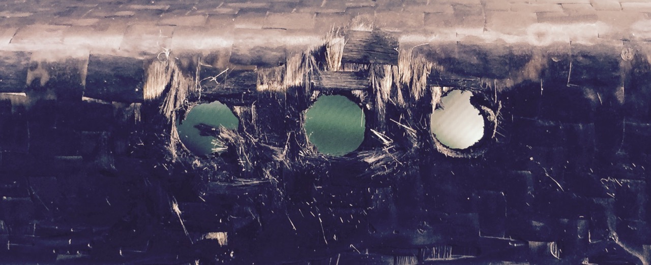

bleh, I need to be a LOT more careful with insulation and carbon. while charging my 4mm bullet connector basically evaporated in my hand, leaving me with a coal finger and a partly destroyed enclosure. basically I had a short through the carbon fibers.
its interesting to see what actually happened with the enclosure: it looks as if the resin evaporated, leaving the bare carbon fibers open:

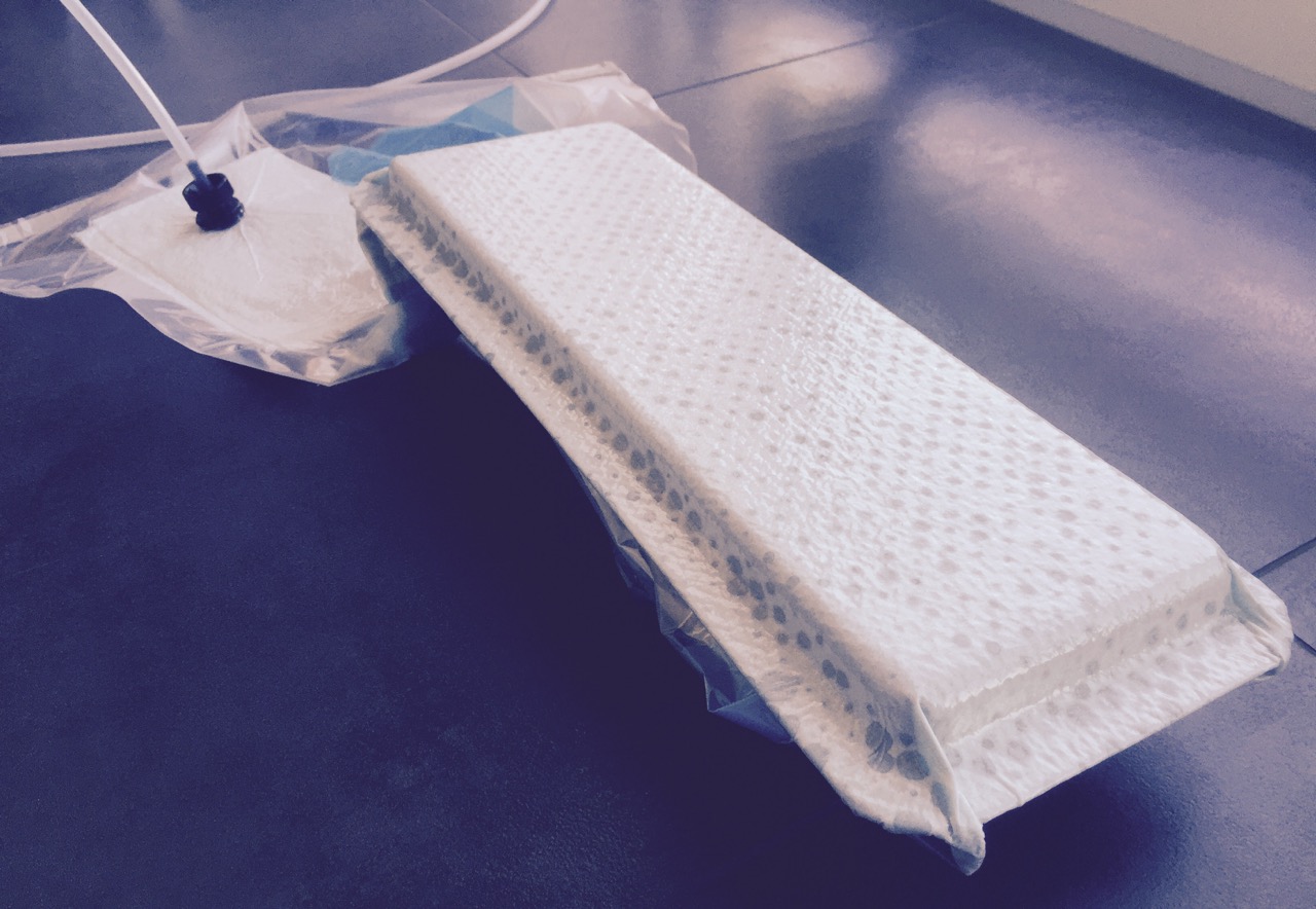

i reinforced the backside again with 3 layers of gfk, used resin to fixate the CFK fibers on the outside again - and to speed it up I let it cure under 60°C with my girlfriends heat lamp:
sanded everything thoroughly, basically removing one carbon layer on the outside with quite coarse grit to leave a large surface for re-laminating another carbon layer
curing as we speak. Ill use much thicker insulation and most of all Ill let the 4mm female bullet connectors stick out a little, so that the male connectors wont have to go through carbon to close the connection!
this better holds up now - repair of the enclosure was successful, thats really a cool part of gfk/cfk laminating. :) made the holes 1mm bigger now and used dual shrink tube on the female bullet connectors. finally I let them stick out by 2mm so that my male loop key will never even come close to the carbon in future! :?
