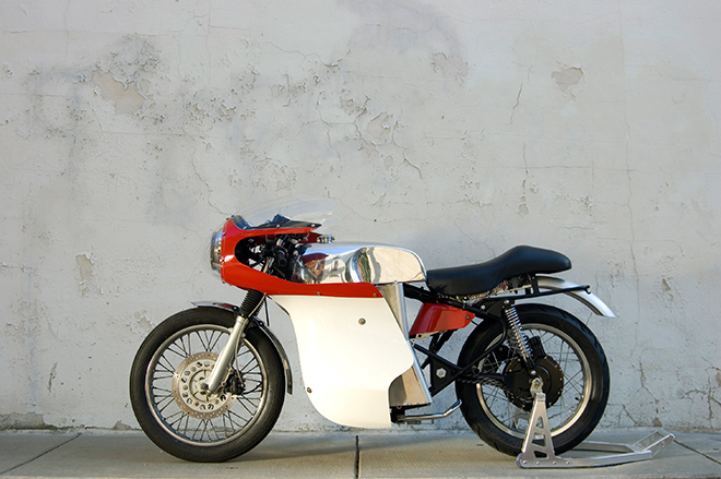

Motorcycle class Hub Motor
A beautiful conversion!
Congrats Mark!! That should do wonders for your business. :p
I think this is the perfect conversion for your motor. The performance level of te ol Brit twin bikes is right on par with current electric technology. And this Hammerhead is a beautiful example of how clean and classy a conversion can be.

Thanks all
Mark
Wow, that photo should go straight to the front of your website Mark!
The hubmotor actually looks like a drum brake on a classic racing bike.
Hello Mark, As if life isn't confusing enough for you. You have James Hammarhead creating beautiful looking "British/electric" motorcycles using your hub motor, and John Head, who restores British motorcycles for a hobby, making a leaning three wheeled trike using your great product. I'm eagerly looking forward to meeting you at Mid-Ohio.
