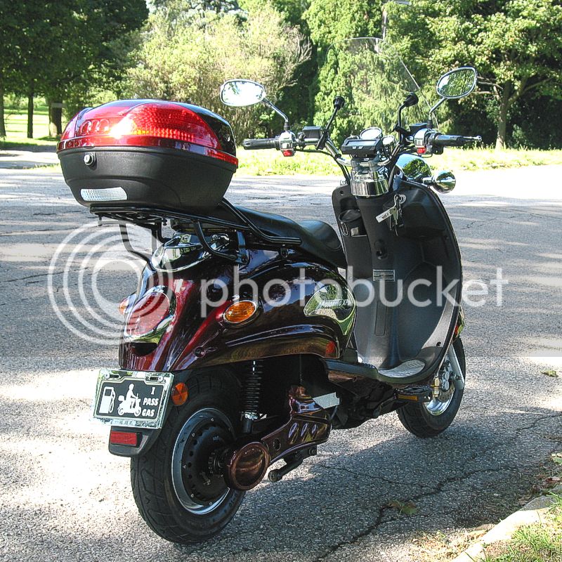

I got a nice 12 km ride at mostly high speed. I also have a low speed that is governed at 33 km/h on flat ground to obey the law :roll: But I switched to high speed often to see how the system behaved. First off, I don't know why I don't have regen anymore, it just doesn't work and I would like it to work to save on my brake pads. Second, after tweaking the controller, I have adequate torque, a low speed to obey the law and a high speed of sustained 60 km/h on flat ground. So I'm not part of the 40 mph club. After the ride the motor was at a surprising 181.7 degrees Fahrenheit on the windings and 122.3 on the end caps. The brake disks were still glowing red :lol: Well not quite but they were really hot. 225 pounds of scooter and 245 pounds of rider is a lot of weight to bring to a stop. Here's a few picks of the battery, it's in two parts because it is easier to place it in the battery compartment that way. And picks of the CA readings, I think my CA is a bit off, I don't think I went at that top speed but maybe I did going down the other side of a big hill I went up, and the wh per km seems low, like if this is accurate then I am really happy with this. I glanced at the Wh reading a couple times and saw 4700+ on acceleration..

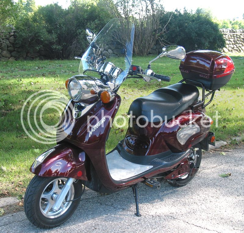

The wind screen I installed last week is a bit small but it does the job. Although I feel I still have wind hitting my helmet, I feel much less wind on my torso and this should help me this winter. I'm hoping for very little snow like last year so I can ride everyday. Some pics of my baby as it stands right now. It still looks good after travelling 4950 kms. I have some LED lights that I'm contemplating for the rear brake light and the front and rear signals. I'm hoping the LEDs will be a lot brighter than the incandescents in broad daylight. I'm also thinking of putting a Xenon headlight bulb.

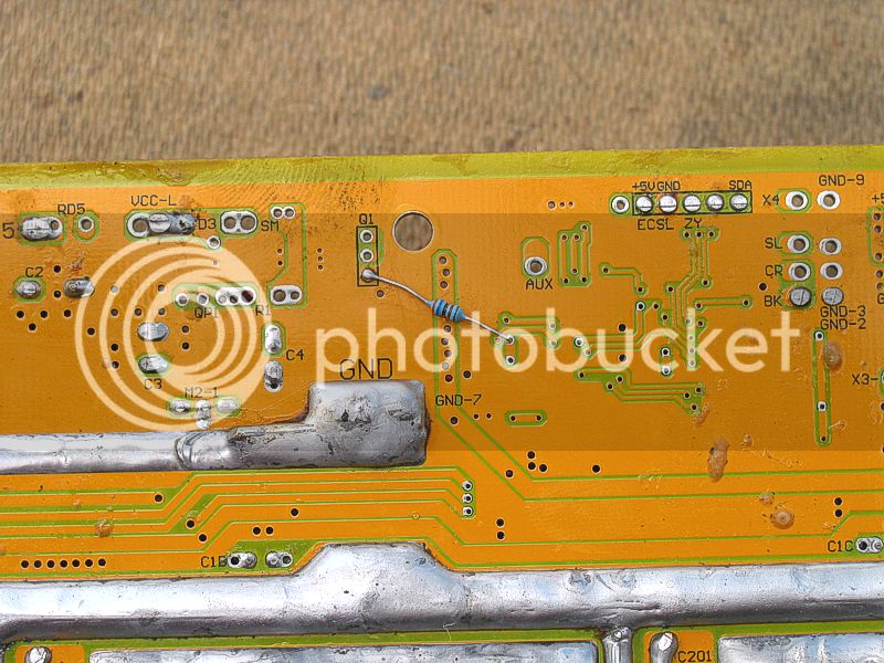

I got this from Lyen
And he told me to solder it here on my controller's board. The board is one of the new 318.
And after reprogramming the controller, I got my regen back.
So after much reading on this modification, I found out that after modding the controller with this resistor, it now regenerates 1.2 times more than it did before. So when the program is set at 75V regen, it really does 90V. 75V X 1.2 = 90V. And when programming the LVC you have to multiply the low voltage you want by 0.84 to get the real LVC that needs to be programmed in the controller. I wanted my LVC at 66V for 20S so 66V X 0.84 = 55.44V. So I set the LVC in the controller to 55.5V. Hope this helps someone else. Thanks to everyone that helped.

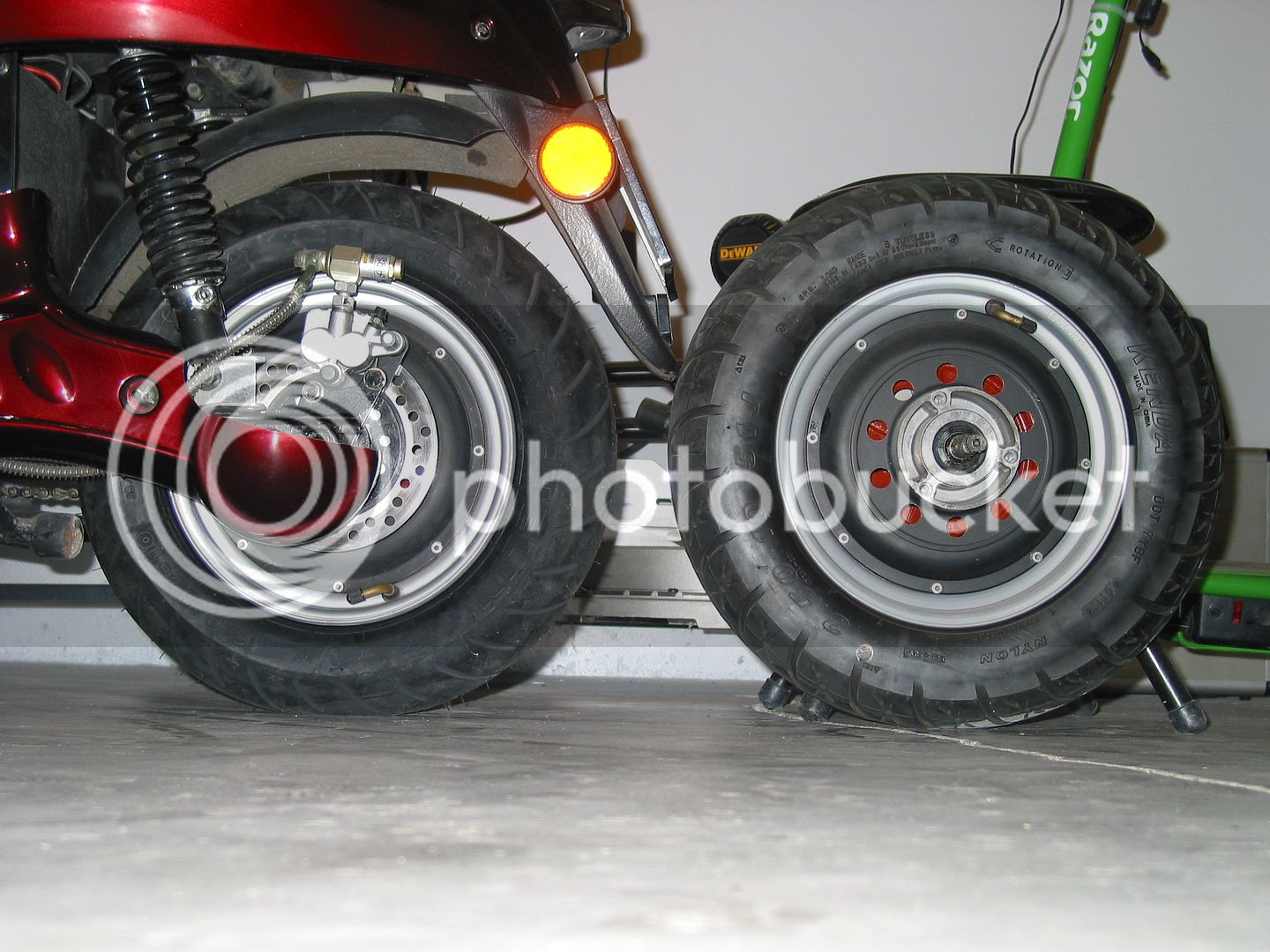

So now that winter is coming on, are you ready to go 2WD?
Looks like this motor would bolt right on the frt. end of that model.
http://www.conhismotor.com/ProductShow.asp?id=284
I know the extra motor I have won't fit between the front forks. I rode my scooter all winter last year, from that experience, I know that if I get caught in a snow fall and it starts to get slippery, I definitely don't want traction on the front.

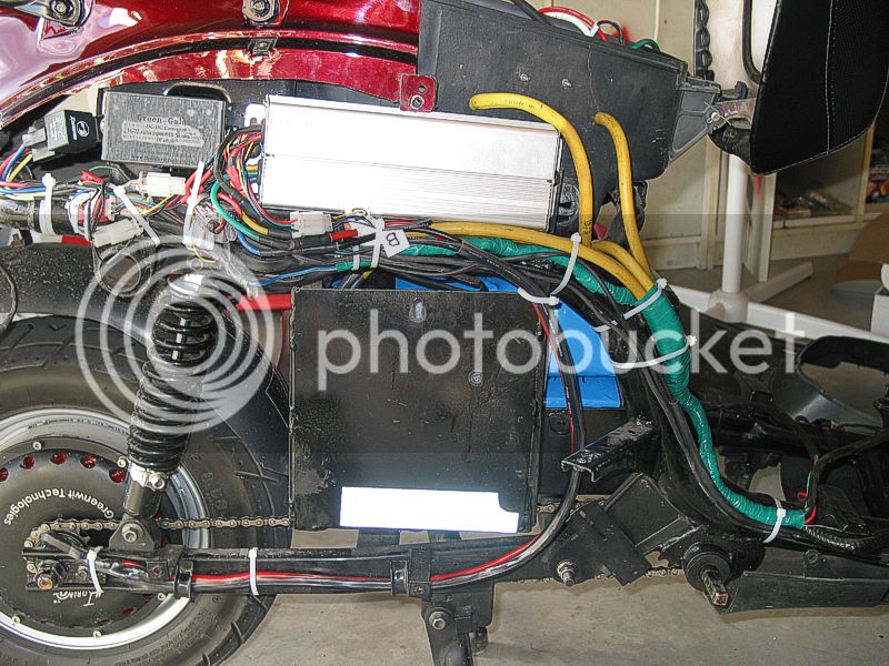

Like I mentioned in the battery forum and I plan on cleaning up the spaghetti mess I presently have under the seat. I want to bring it down to just two 6 mm connectors like the ones pictured below and that single DB25 cable for the balancing wires.
I started cleaning up my charging set up for the 20S20P konion battery. I started on the charging end and maybe next weekend I'll find time to clean up the scooter end. So the battery will be split into two 10S packs instead of four 5S packs. That means there will only be one connector for each of the two Hyperion chargers and just one DB25 connector for all the balance wires.
The two main connectors from the battery will need a series connector after the charging is done which I made already.

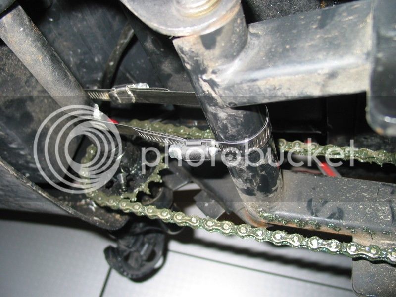

If anyone is riding an e-scooter like me in Ontario, you know how important it is to keep the pedals on. The problem is that those pedals can catch on the pavement when cornering and they can send you flying in the ditch. The trick is to keep them horizontal, some do it by keeping their feet on them. I personaly prefer to keep my feet inside the scooter especially this time of year. To keep the pedals horizontal and still keep them on and functional to obey the law, I put a couple hose clamps underneath the scooter going around the pedal shaft and the swing arm's cross member. I tightened the clamps as tight as I could and now the pedals stay firmly horizontal but are still functional. They are difficult to pedal but they work. Only one hose clamp is shown in the pic but I put two of them.
