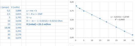

What could measure lower resistance? Anything could be obtained for not much money?
The voltmeter + the ammeter you have are pefect for the job. The best way to measure a very small resistance is to use an indirect method (measuring voltage drop at different current loads... when you plot voltage in fonction of the amps, the slope of the graph wil give you the average resistance value).
No need to buy a 4000$ Hiroki meter...
Best way to do it : measure voltage drop at different load values. From voltage drop (dV) and amp (I) values, you can calculate R from ohms law.... But to be more precise do a multiple point analysis (take masures of different voltage drops at different load values). Take video filming amps and volts at same time.
Than you can make a graph and get very good regression correlation....
The only think that's really important to take voltage reading at the NEVE module post so we know exactly the resistance of module by substracting the resistance of cells themselves. This methodes eliminate a third variable, that is, the resistance of the big wire cable that goes to the nichrome load.
Your volmeter is already very good...¸
You have to take voltage drop values at different current load to get the resistance. Make a graph and deduce R of NESE with cells.
R of NESE without cells = R of NESE with "Brand-X" cells - R of parralled "Brand-X" cells.
Knowing the empty modules resistance, you can anticipate the resistance of the pack with any sort of cells when you know the resistance of that particulare "Y-cell".
The precise why is doing the graph like I did... The most point, the better the precision.

Most error margin will not stem from the meter, but from the fact that at higher loads, voltage drop will not only be the real voltage drop (originating from internal resistance) but also normal discharge of cell.... You have to take that into account.
Rather than ploting V in fonction of I
Plot dV in fonction of I...... Knowing V under no load (zero amps) will not climb out the the inital voltage after you remove the first load experiment you apply.
you have to remeasure V (no load) each time you add a new load to make sure that dV only represents voltage drop and not cell discharge.
The faster you take the measure, the better.... that's because when you'll put high loads (ex :20A/cells), the cell discharges very fast so you have to take the two measures (V and A) very quickly.... I recommend filming the two meters (V and A) at the same time, that way you can playback at low speed and catch the two values at the same time.
Your 3 voltage digit voltmeter is not the limiting factor here... That's more than enough.
Also, I trust you DC clamp meter more thant the chinese diplay.
Not that I don't trust chinese stuff, the problem is you dont know if the ammeter shunt they use have been calibrated to strict standard, loosly calibrated or not calibrated at all... they dont give certificate of calibration.
On the contrary, your clampmeter most likely has been calibrated. Ideally, meters are most accurate when you measure something around 2 thirds of the display scale they use (alsolute error in units is the same, but relative error (in % of units) is less).

Then it calculates resistance doing the method I did with the regression graphic (V = - r . I + emf) for every different possible SOC.
Then it would make a graph of DCIR in fonction of mAh (SOC).
If somebody invents this... I'm buying. It would need to be pluggable to a computer.
Imagine... 0A, 1A, 2A, ... 30A. You get 30 different curves of V vs mAh
Then for any SOC (ex : 100%SOC, 90%SOC, 80%SOC).... for any one SOC, you get 30 datapoints (x=I ; y = V) and each resistance value you get for each SOC is made buy calculating the slope with a 30 point graph regression analysis.

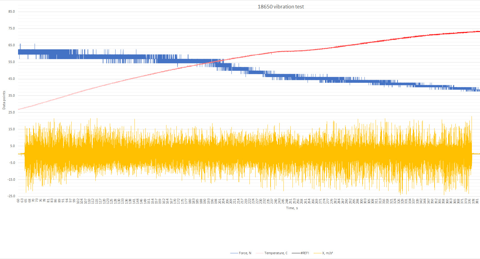

I have a new test setup, this time in my mans cave. How low can i go is my question. I will try to run a heavy load and knowing that cells bounce back, how low can i drain them to be sure they gave all? 2.5V, 2.0V?
Did look at the vid. Nice work.
So INITIALLY you had : 4.192V no-load and 3.395V@159.6 A, which is 3.395V@26.6A per cell (6P pack)
FINALLY it finished at : 2.314V@91.8A, which is 2.314V@15.3A per cell.
Recoverd to 2.950 after test (and still rising 1 mV per 2-3 seconds)…
I placed these values on the graph (se my previous post) to extrapolate values.
From volt-amps reading you have INITIALY (about 100 % SOC), there is 4.994 mOhm resistance (0.797V drop @ 26.6A).
From graph, DCIR of cells is 26.2 mOhm @ around 100% SOC, theoretical. So 6P pack 4.372 mOhm theoretical.
This means at close to 100% SOC, the NESE module only adds 0.622 mOhms ! Wow, that awesome.
From volt-amps reading you have FINALLY (about 0 % SOC), there is 6.928 mOhm resistance (0.636V drop @ 91.8)… is very inacurate at less that 20% SOC charge as graph voltage decline abruptly and I'm sure cell resistance is way more than 23.3 close to 0% SOC.This is a crude estimate, and also not that the recovery voltage (no load) was still rising and not totally stable when camera stopped (But let’s say 2.950 – 2.314 = 0.636 V drop slight underestimate).
From graph, DCIR of cells is 23.3 mOhm theoretical @ 0% SOC (probably very inacurate estimate at that part of the graph since voltage is declining so abruptly). So 6P pack 3.389 mOhm theoretical (i'm sure theoretical value is way more than that nearing 0% SOC)
So all in all, each 6P-NESE module would add around 0.622 mOhm to the cells in parallel (6 cells). This time, the calculations are not affected by the long cables, as the voltmeter is checking voltagge drop directly onto NESE module posts.
Although my calculations are crude, 0.6 milliohms for one 6P empty NESE pack is close to adding almost no resistance to the intrinsec internal resistance of the cells themselves. For each 23.3 mOhm cells, NESE only adds 3.6 mOhm per cells (six in parrallels is 3.8 mOhm of 6P cells + 0.6 mOhm of 6P connector metal).
i think it is safe to say that the NESE encasing systems (with all it's intrinsec connectors) is in the 1.0 ± 0.5 mOhm range (my calculations are a bit crude), but the number or order of magnitude number seems like what's coming out of my few previous posts, after eliminating the parasitic effect of long cables on calculation.
Again, really impressive Agniusm. This is a breakthrough!
BTW, I'm not surprised by the 75°C considering you pushed the cells over the top at 26.6 Amps/cell... :twisted:
I said i want to :D
Anyway, i am blown away myself. 120A per 6P is not too shabby at all. I mean you can dry cells at this rate and NESE connections are way lower than cells them selves which means in this system, only limiting factor is cells, not the kit. I am happy camper now.
