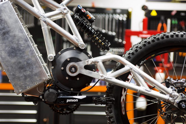

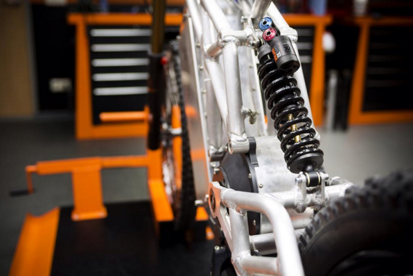

I was happy to read your discussion about the rear suspension of our bike. What crossbreak mentioned about reaction forces during acceleration and motor breaking is really relevant but it is not a fault. I would rather say it is a trade-off. When we were choosing rear suspension/transmission design, we thought about three cases - mounting motor in the frame (not on the suspension axle); mounting motor on the swing arm pivot point and react torque to theswing arm; and mounting motor on the swing arm pivot point and react torque to the frame. All these concepts have their advantages and disadvantages.
The first one (as it is on LMX P2) might give you less squat (suspension compression due to traction forces) if the chain goes close to the swing arm pivot point (when it goes on the chain slider). However, when the rear suspension is compressed and the chain lifts of the slider the chain force that compresses suspension also increases. This effect anlso increases with increased rear sprocket diameter.
The second concept gives the least influence of traction force on the suspension. The chain forces are reacted on the swing arm therefore they do not influence suspension. However, mounting motor on the swing arm increases the moment of inertia of the swing arm and also influences unsprung mass. If the motor is not large, then the inertia forces are negligible. However, 20kW motor is quite large and might give adverse effects on the suspension.
The third concept is what we are currently after. This concept gives some suspension compression on traction. The suspension compression due to traction force depends on the traction force but does not depend on the position of the swing arm (up or down). Also the sprung mass and sprung inertia is minimized. We tried this concept on our first pre-prototipe (one with relocated hub motor) and the outcome was satisfying. During testing we did not find any adverse effects that would make ride worse.
We have second concept in mind. With the current bike design we can easily react motor torque at the swing arm and see how it feels.

The explanation of swingarm behavior seems spot on to me, which one to you think would give the best grip, accelerating on dirt?
And in the suggestions category, could i just say that the rear sprocket in the top pic from agniusm last page has massively raised stress points concentrated around the bolt holes, no doubt software would pick it up, prolly a test one though and not meant for anything like 20kw, and by the way do you mean measured at the battery or the tyre?

Regarding swing arm, I cannot wait until we do proper testing. It is hard to say which design will work best. If you check the suspension design of other off-road, rally raid cars or motorcycles it is possible to spot some trends. Usually, unsprung masses are kept low because of high accelerations going over rough terrain. Usually they have some anti-squat for rear suspension, but not too much. With our design we wanted to give rear suspension more anti-squat than they use in offroad motorcycles. Extra anti-squat reduces reaction forces riding over rough terrain because of swing arm angle. Also it allows to use softer springs because suspension squats less on acceleration. We will see how it works after we perform proper testing.
Regarding rear wheel and sprocket. That is true, streses there are high. Thanks for feedback. We wanted to use rear hub from dowhill bikes, because it allows us to use rear bicycle wheel. On 20kW version this might need to be changed.
20kW is electrical power (motor, controller, batteries), not tyre yet :)

I was making a stop at their facebook to see if there was any news or pics update. Then I discovered something I have not noticed before.
Just above and in front of the motor, kind of between motor and rear shock, there is a square box. Controller? Radiator for water cooling? As I browsed slowly over the pics at face I really can't see anywhere else they can fit a radiator without altering the design of the bike as it stands in those pics. Think we are seeing the final stage bike in these pics or is this still a rolling demo/prototype version that will be altered in many ways before bike is released?
