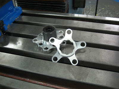

Reduction will go as follows:
Stage 1: 20:80 via belt (1:4).
Stage 2: 16:34 via bicycle chain (1:2.125). 34 is a constraint here, I want the smallest commonly available chain ring that fits 110mm BCD. This gives me 1:8.5 reduction at the input to the NuVinci left side drive sprag clutch.
The 16t driver on the second stage is going to be a freewheel in the very short term, as a failsafe in case the sprag clutch seizes while in use. I can get more reduction by shrinking that freewheel to 15, 14 or 13 teeth (13t = 1:10.46 reduction at the NuVinci input).
The NuVinci output to the rear wheel is a chainring mounted to a 130bcd hole pattern. I want this as small as possible - 38t. If I use a 50t chainring at the rear, I'm getting a further reduction of 1:1.3, leading to a total motor drive reduction of between 1:11.2 for the 16t fw and 1:13.8 for 13t fw. This will put my performance very close to the 1:12.2 I'm currently running on the 20" wheel folding bike (as a design goal: Get the thing moving with performance characteristics I'm used to, then perhaps make changes from there. The folding bike has great torque and a top end speed of 33mph).
Once this thing is built and proven, I can easily swap that 16t freewheel out for 17t or 18, for higher top-end speed...

Quick update -
I'm thinking of using one of these (see pic below) to drive the freehub. The rear wheel will need a 30 - 54 tooth chainring in order for the rest of the bike's gear ratios to work out.
