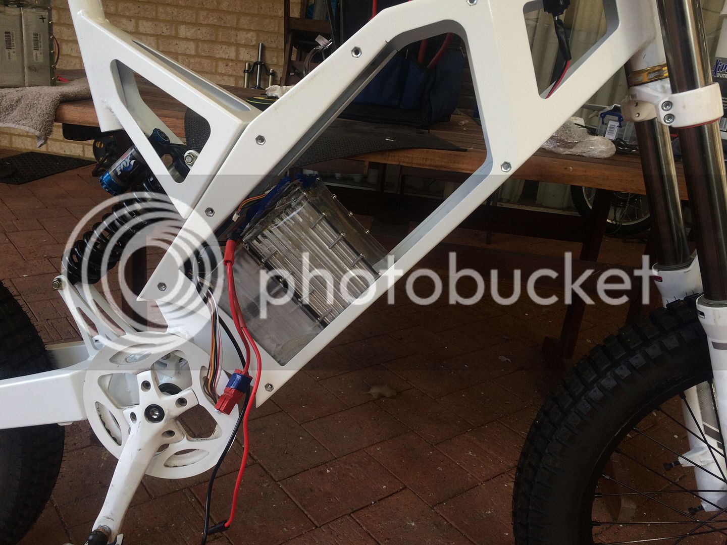

Nickel, JP Welder, BMS, cell spacers have all arrived. Have ordered individual and 4x cell holders to test BMS with.

I'm stewing over how to wire the packs together. Its really tempted to create 48v 18650 bricks (no fusing within the brick), fusing on the exit. Sense wire to BMS, has same effect as welding it all together but has more connection points for failure. This would have the advantage of being easier to replace dud cells and to use the bricks for other purposes should I want to.
Connections at brick level are likely to be made by XT60 connector, haven't yet decided on the source or whether they are rated high enough (aware they are meant to be 60a, but at what voltage? Is voltage even relevant?). So far many of XT vendors selling them don't actually seem to make any statements about their rating or max current, yet some sites claim that only the original design by Amass in China and sold by HK are capable of 60a and the replicas current handling is dubious. They can be purchased with the wiring already soldered and heatshrunk just requiring soldering to the packs. Any BMS connections will be JST. Nice summary about connector choices: https://www.electricbike.com/ebike-connectors/
Wire gauge is likely to be 12 AWG to match XT60, just need to ensure the rating is sufficiently above what will be used.
