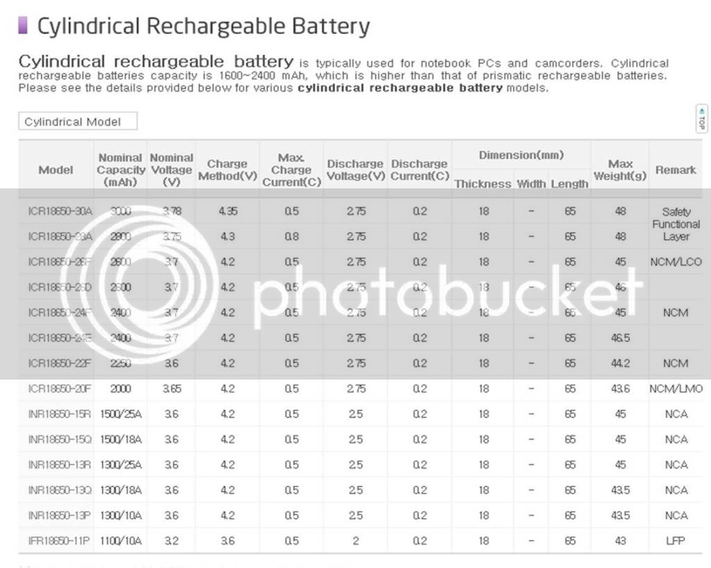

The samsung one is NOT NCA in my opinion, or that's not the right graph of it if it is. NCA should have a ~3.6v nominal voltage and a long gently sloping discharge curve.
Also, on that list, I saw nothing that would make me think an NCA cell. You know IMR means spinel right?
Random unverified info from the web...
First off, this will explain their names:
In the case of IXR, the first Letter "I" just means that the cell is a Li-ion rechargeable. Second letter refers to the cathode material. The last letter "R" just means the cell is round.
ICR: the "C" = Co which is Cobalt.
IFR: the "F" = "Fe" which is Iron
IMR: the "M" = "Mn" which is Manganese
The NCR chemistry [name] is a Panasonic invention - it is LiNiCoAl chemistry in full nomenclature.
There is the Panasonic:
NCR18650__(2900 mAh)
NCR18650A_(3100mAh)
NCR18650B_(3400mAh)
The also rather new NCR18650PD which also has 2900mAh but, it is different to the aforementioned in that it is a high-current cell that is claimed to sustain a 10A load, just like the Panasonic CGR18650CH (IMR chemistry).
That graph is for the AW 1600mAhr cell. which is listed as an "IMR" Lithium Manganese (LiMn2O4) .
and has apparently been tested at 24A discharge :shock:
Note the slope of the graph is distorted by the different voltage scaling ( vertical axis)
The "dampfakkus.de lists show the chemistry on a separate page if you click on the cell model number.
Lots of cells are listed as NCR / LiNiCoAl chemistry.
But as i said there is much confusing and contradictory info floating about. :cry:
