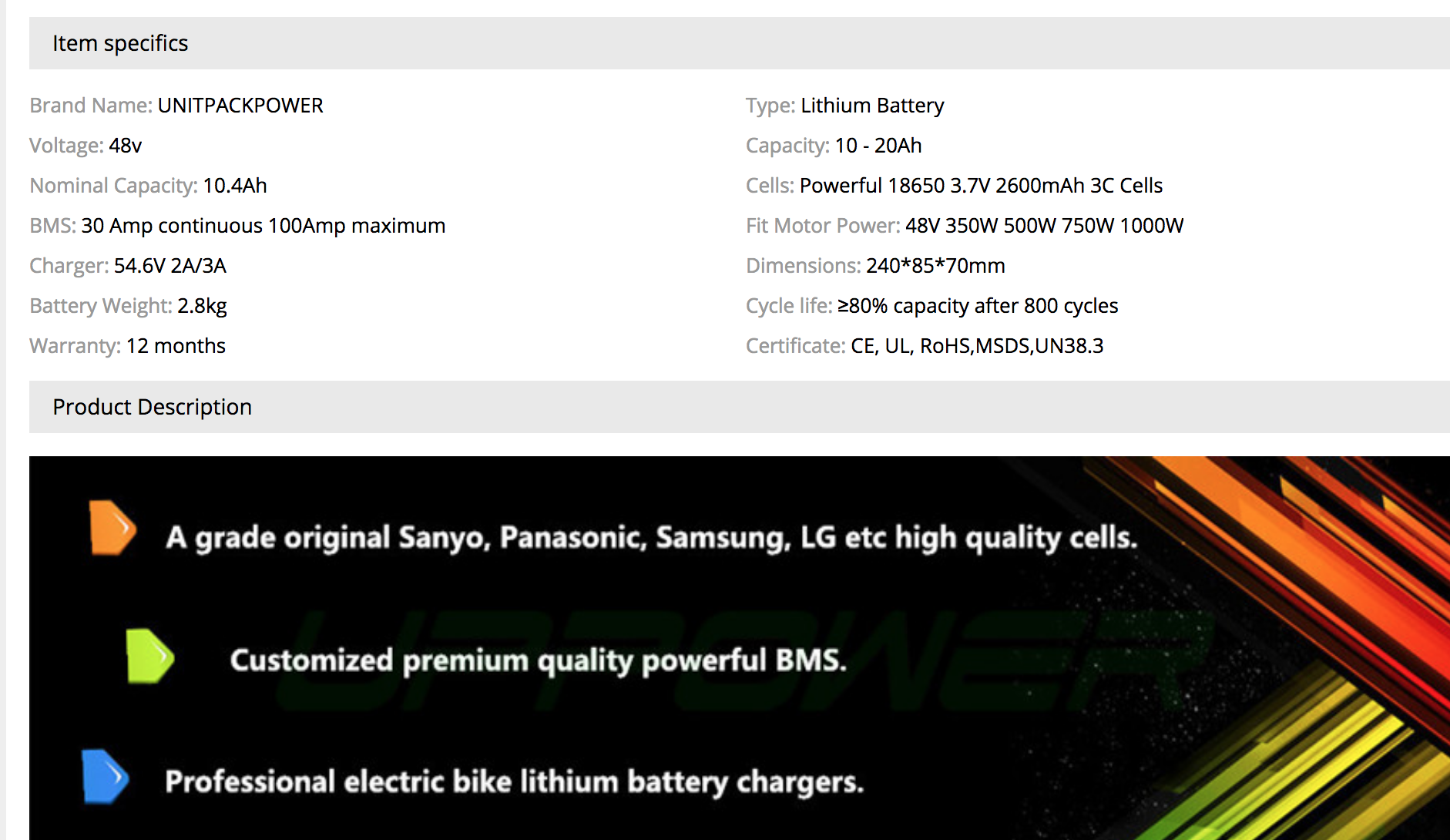

Thanks for the links. Luna quote 6-8 weeks delivery for batteries with no tracking which is no fun for me.
I'm waiting for a response from 'Jimmy' or someone from https://www.bga-reworking.co.uk so hopefully they come through for me.
Okay, i've made the decision now to just go for the kit and battery from AliExpress and upgrade when I see fit.
£467 (£500 ish incl tax) - For the kit (suggested seller from a previous poster):
https://www.aliexpress.com/store/pr...225.html?spm=2114.12010615.0.0.9d3da095mvTi97
<£200 the battery from UnitPackPower as suggested by the previous other poster from AliExpress:
https://www.aliexpress.com/store/pr...303.html?spm=2114.12010615.0.0.7a052d20dZrRIk
The battery says 30a continuous which I think is what was recommended for the BBSHD.
I've spent far too long researching batteries so until pay day these two will sit in my basket and unless anything changes will be ordered.
Thanks for all the help and discussion, still open to criticism on the battery choice.

Okay, sound advice.
I received a reply from Jimmy so will most likely be using him for the battery.
