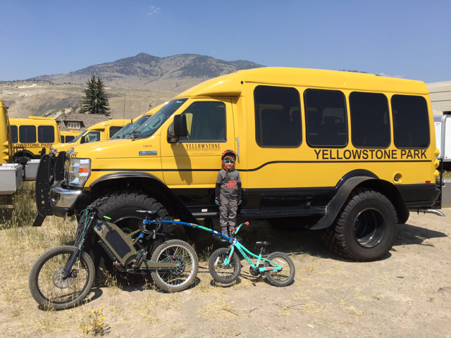

And here's what happened to the old one! I was in Yellowstone with nothing to ride and a sad sad look on my face. Rix sensed something wasn't right in the world, called me on the Batphone and flew across state lines to restore eBike riding happiness. In reality, we both spent the better part of a day driving towards each other to hand off the bike but I like the batphone and flying story also.
Here are 2 ES FUTR fans yuckin it up in front of an Alpha.
It got a payload too... it was awesome pulling my son around the park. I am a big guy so with me, my pack, gear, tow bar, my son and his bike, and the Alpha itself, I bet that motor was pulling 450 to 475 lbs.
The last one was before my son and I climbed Mt. Washburn (seen waaay in the distance). It didn't go so well but we eventually made it. I think we might leave big loooong climbs like that to non-hub motors next time or drop a lot of excess weight in preparation!

Nice pictures Jason, glad the Yellowstone trip worked out. Indeed it was a long day drive for both of us. I left at 4:45am, got home at about 7PM. I did stop for dinner though. Pulling around 475#, any issues with over heating?
@Cricket_swe, nice and clean routing.
Nice bike attachment. Hopefully the young fella doesn't cop a roost in the face!
