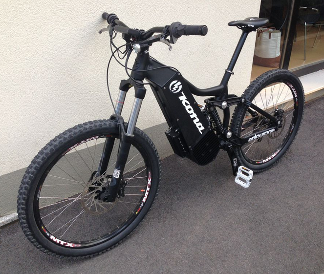

From Quiksand, he rides offroad and needed a full-suspension with a system that was light with good ground clearance. Eventually, he switched to a motor with more copper mass, a BLT-500.
