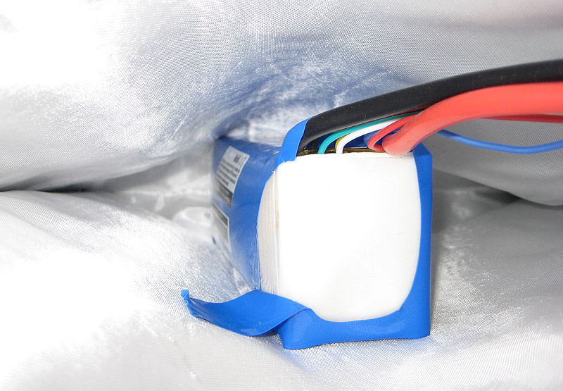

I think that a backpack battery is a problem waiting to happen. If you fall, there is a high chance that the battery pack will hit the ground and you'll be sitting there lying on it.
I think that triangle packs are the safest way to mount any battery. Your pedals, rear wheel, and front fork will prevent the battery pack from hitting the ground if you dump the bike.
I had a serious accident where my bike probably even rolled, and my RC Lipos did not take a scratch. They did not even any additional padding or protection. I still use that pack today. It's the handlebars, disc brake, fork, and rear wheel that got dinged really hard.

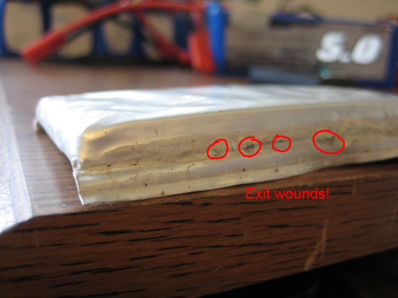

Ever seen a RC Lipo pouch cell?
Even better, ever seen how far one can puff?
There is extra material on the edges that is folded on each of those cells, which unfold under pressure and allow expansion under stress.
Here is an example of a lipo cell 'unfolding' after being abused.
This is a safety feature. It also allows an easy visual inspection of a RC Lipo cell in order to determine it's health.
I actually had a 1 week old RC Lipo pack do this to me on the blue, before i'd even gotten to cycle test it. It had shorted internally very slowly.
If i would have compressed the pack, i would have never caught this in time to put it in a fireproof area and let it do it's thing ( luckily, it just emitted a little smoke ).
A healthy cell expands and contracts slightly under various states of charge as well. If you compress things really heavy at the wrong SOC, you're gonna have a bad time. I say just avoid it. I don't know of any performance or longevity advantages to that practice.

Punx0r said:
neptronix said:
They are designed to do that as a way of relieving internal stress
I'm not sure this is true...
It wouldn't explain how can cells survive, nor why pouch cell manufacturers like A123 specify compression requirements for pack builds.
I don't see the extra material in the last photo? It just looks like a square shape gone round.
Part of the flaps that are not glued/sealed are the extra material that helps the expansion happen. Lipos can puff up to almost twice their size.
If you took a RC lipo cell that was brand new and abused it to the point where it puffed ( usually this is due to heat ), you'd be able to observe this in person.
