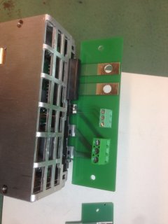

Hi All !
I have done a small breakout board for the Flatpack2 and Flatpack2HE.
It looks like this
And inserted in the Flatpack it is like this:
REgards
/Per
