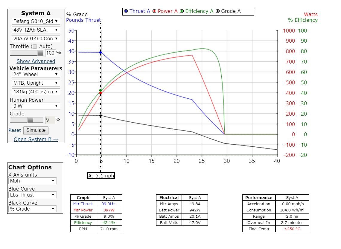

this new cargo bike looked like a good deal untill I did a simulation of the motor. does any one know how to omake it perform better? other than mounting the motor to the side and using a large gear reduction.
I have not tryed simulating it with higher voltage, but that would really need a larger gear reduction, right?

You are not Pressing 'Simulate' after altering parameters and thus getting bogus results.
Here's the 2WD version with your proposed 400lb load... 26+mph:
Upgrading to a modest 25A controller shows the plain vanilla 1WD at 16mph up a 5% grade with a 400lb load.
With 25A controllers, the 2WD version does 24mph up a 5% grade.
IMO, cargo bikes need big hub motors, or mid drive, unless the cargo is to be a 150 pound rider and a lunchbox.
Thats just another cargo bike fail, using a small geared motor. The small wheel helps to be sure, but its not going to do well loaded up above 300 pounds total weight. Period.
That bike would rock with a mid drive though. Or even just a decent DD hubmotor, that could put out 1000w. With a motor able to put out 2000w and stay cool, it would be a "cargo bike" that does not fail.
