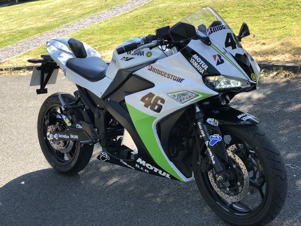

I went through the same dilemma and calculations.
Ended up buying a road registered bike in the UK and converting it myself using QSMotor 4Kw hub and Kelly controller. Invested in a decent battery (72V 40Ah capable of 150A bursts using Samsung 40T cells).
All in with shipping for motor and controller and the bike itself (which was a year old Chinese R3 clone, Yamasaki brand) I spent equivalent of $3,500.
To be honest I looked at importing a Hanbird electric motorcycle from China but even with SLA lead acid pack by the time I paid import and shipping duties it was more than $3,000 equivalent and wasn’t even certified for road use. I know someone who put it through the certification test here in UK (MSVA) and spent upwards of $6,000 all in with the changes they had to make.
I’ve now got something that is the size of a 600cc with decent performance. Max speed is around 60-65mph with very strong acceleration once you get the hub spinning to start with. Range is about 35-50 miles with my 40Ah pack depending on speed but that’s all I wanted and I can easily fit a pack 3x that size if I want to in the frame.
My colour change and stickers may not be to everyone’s taste but I like it :)
