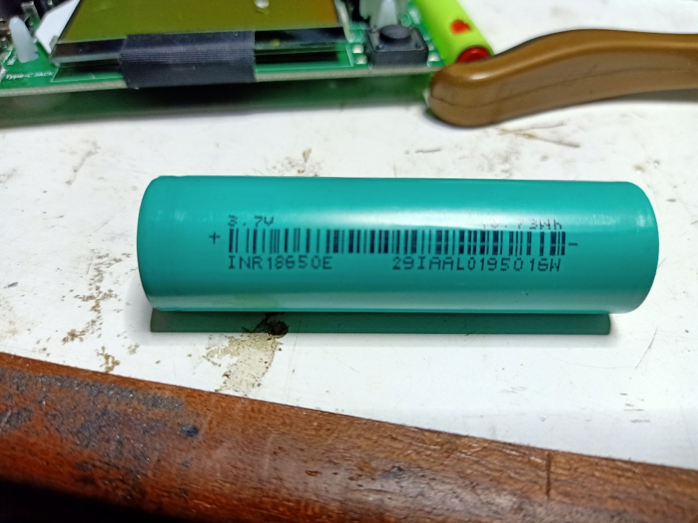

Dear Forum, for my E Kart I am now working on the batterie pack.
So I have purchased LIPO BIKE PACKS. Six of them with integrated BMS. I opened one pack and saw a separate port to charge the 36V pack. Ground is switched
So two packs in Series. Times three.
Here my thoughts, I want to bypass the Mosfets and connect the B- and P - together. BRIGDE THEM.
I am not sure if the safety circuit is activate if I desolder B Minus from the pcb.
I want to use the balancer and charging function. The 72V is going to a big contacter !
This contacter 12V is controlled by an Batterie protection circuit to disconnect it when the cells are below 55V.
Is this a way to go. Let me know what you think?
I have the cells, the contacter and all kind of extras already.
Good day Bob
