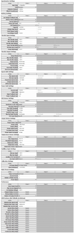

The setup I have is fundamentally working but not the way it should be. Without the Cycle Analyst plugged in, the motor 'takes off' when the throttle is engaged. When I plug in the Cycle Analyst there is no 'bite' at all and I estimate the wheel spins at about 1/2 speed. Any ideas on that?
I've attached screen shots of my current settings. It would be great if you could cast your eyes over my settings to see what I'm missing. This is my first build - I bought this same bike as a completed build over a year ago but it was stolen. I got the bike back without the electrics and am only now about to complete the rebuild....
Current Cycle Analyst V3 Settings:
Lyen 12FET Settings:
