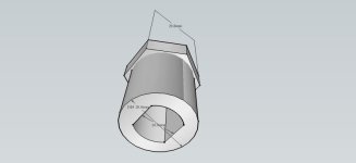

so both my dh ebikes have 200mm travel stantions with 20mm axles. boxxer ones.
and I have wondered for a while about the viability of creating an insert which would allow the use of a hub motor on the front forks which normally take a 20mm axle.
I saw Justin's hub motor that can do this and this is my poor (with lathe) mans alternative if indeed it can work.
The idea is that you try your best to get the axle through with the wiggle room that the 20mm give you on the fork, you may need to cut one of the axles short and/or spread the forks(I don't really approve of this) and that should allow the hub maybe to go into the fork loosely. then from the outside of the forks push on the inserts each side over the axle and through the 20mm hole. the hex is to provide extra flats for a stronger torque arm to grip.
I am thinking flat tyres would be a pain to I would use those linear inner tubes where you can take them off without removing the wheel.
Still I fancy giving this idea ago but don't have the time so figured Id put it out in the wild for others to maybe run with.
