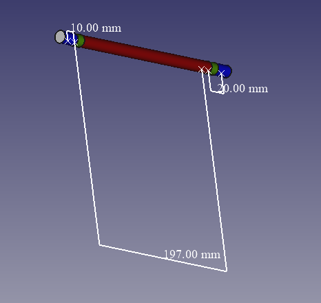

Hi!
Need to make a 12 mm axle for a rear 197mm DT SWISS Hub 350 Big Ride hub, (axle with nuts)
What diameter and length (smooth 197mm?) should the axle be?
12mm precisely or should I make it 12,1mm etc?
Thanks in advance!
Just buy an m12 bolt with a nut, that is what I have. The space between the two dropouts is 197mm, add 10mm for each dropout hole and 20mm to secure the nut.

Red: 197mm Smooth
Green: 10mm Smooth
Blue: 20mm M12 thread
Like this?

Yes but you can have a bolt with a head on one side so you would only need 1 thread.
You can measure your dropout thickness to be sure about the 10mm but I would rather have too much thread than too little. I have a steel bike (100kg incl. me) and steel axle, the thread rests on my dropout on one side and has caused no harm so far.
