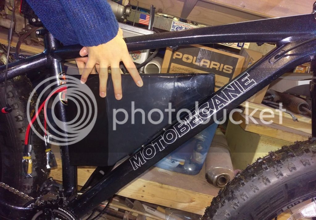

This is my first eBike build, a mid-drive fatbike. I installed a BBSHD and 20 AH Panasonic ICR18650PF Triangle Pack, both from Luna Cycles, onto a Motobecane Sturgis Bullet.

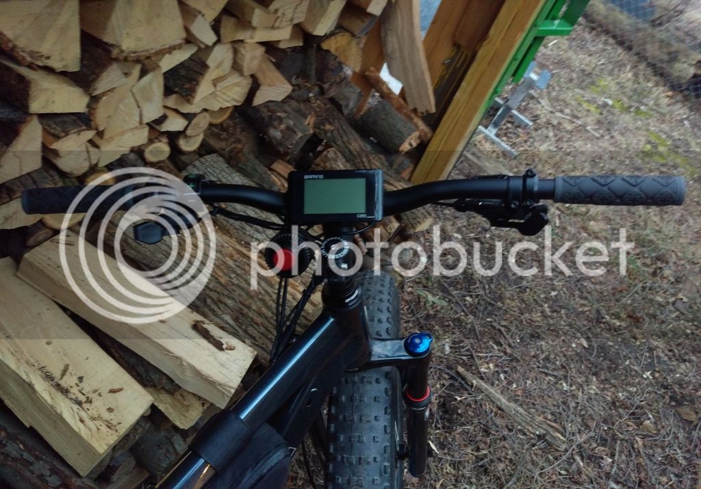

Below, note left thumb throttle replaced the front shifter. That is not a sleek looking looking or comfortable throttle lever, but it isn't horrible, either. I'd like to eventually replace it with the old shifter lever:

I chose this model bike in particular because it comes with a ($600+) Bluto fork and has a relatively open frame triangle for battery clearance. It also comes with nice components such as Mulefut tubless-ready clincher wheels, and Snowshoe tires.
I chose the 120mm BBSD kit. I wanted the crank arms centered on the frame. The right side pedal clearance is set by the motor, and nearly all the shimming was on the left side, so a 100 or 110 mm kit would have resulted in the same pedal spacing anyway, if I added a offset LH crank arm to get the pedal spacing symmetrical. You need to cut off about 5mm from the front derailer mount on the frame to center the install (motor just touching rear triangle) and to get the best chainline. That 120mm kit fit very nicely, with only shimming, once the shifter bosses were shortened.

This was not a difficult build by any standards, especially by Endless Sphere standards, where members are known to conjure their own motors out of iron, copper, and magic! It's mostly a kit assembly job, with a few custom spacers needed. I did it in 2 days, and a lot of that time was spent double checking dimensions, deciding how to execute packaging, or soldering. If you can turn a wrench and solder, and don't do anything foolish with wiring the 52V system, you can probably put this project together with no issues. Do get the proper bottom bracket tools unless you are ok with mangling parts.

Luna also has a battery bag with eyelets so the builder can use zip-ties, but the Velcro bag is more water-resistant, so...good call.

For the rear shifter cable, I think I know what you mean - it routes under the bottom bracket, on the RH side of center, so it winds up between the motor and the BB. I was careful to keep it as far to the right as I could, and it works well there. There is enough clearance so it is not pinched. Stock routing worked OK. Here's the way mine was routed - it's the bottom cable in this pic. The top cable in this view is front shifter, which gets removed.
I recommend you grind a little material from the motor boss where it contacts the frame, so you can get the motor mounted as high as possible, unless you are worried about voiding the warranty. Better for ground clearance, and better looking, IMO. It made a pretty big difference with this frame. I painted it black after the rework - a black Testors paint pen is a handy thing. Like this:

I also have a motorcycle background, enduros. Twist throttle sounds nice. I might try that suggestion. Thumb is awkward. I may switch the brakes to moto style as well (front belongs on RH side!)

Also, I had a hard time modulating the throttle at low power; I think a twist throttle would be better for dicey riding, you were right.
