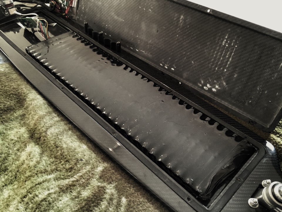

been driving boosted and evolve ... and probably one of the biggest evolve carbon AT fan. I tend to drive intermediate to long distances (15-40km) with my board, so boosted has never been a real option for me. imo the evolve carbon is too stiff for street tires (depends on pavement of course), but simply the bomb with the pneumatic wheels.
the customize & pimpability is pretty high on the evolve AT ... there is a lot of things you can change to make the board better and better. Ive come a pretty long way really:
* DIY battery with double capacity in stock case
* 200€ worth of bushings tested until I reached my dream setup
* riptide wfb pivots
* abec7 bearings with MBS aluminum rims
* sealing tape for the carbon case
* aluminum grab handle from alien drive systems
* absolutely spot on belt tension
right now I cannot think of any detail that would make the board any better really. its simply a gorgeous looking long distance carving machine and pneumatic wheels are a total gamechanger that opens up many roads and tours (especially spontanous "oh, lets take this way" moments) that you would otherwise not even consider. loving it <3
some impressions:
current board with MBS aluminum rims, speed ring adapters and abec7 bearings, in the back you can see the aluminum handle with 3 screws
DIY battery with 20.4Ah for 50km+ range on AT wheels
