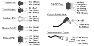

This is my first post here, and it might be a noob question, but I'll post it anyway... Couldn't find an answer by searching the forums or the wiki.
I have a store bought e-bike with Bafang rear hub motor, and the very boring "790" panel (pic: http://goo.gl/eEhyj6). The bike itself is also very boring and I will probably move the motor to another bike soon. My question is: is it possible to use another panel/display, for example one of the LCD-displays that usually come with Bafangs mid drive motor kits? Or will I have to get another controller as well? How can I know which displays are compatible with my controller? The CA V3 seems popular on this forum, would it work?

Hej,
Those 5 wires are the Hall Sensor Wires, and the other three are the Phase wires,
Most any Generic Chinese and/or Infineon , Hall Sensor Controller will work with your 8Fun motor.
But
Not every Display will work with just any controller.
You are best to get the Display and Controller from the Same Place/Vendor.
You say the bike is Boring, well yes running a bike at only 36 volts and 7 amps ( only up to 15 amps max ) is boring.
Are you ready to get a New and Better Battery as well ?
If so you can use 48 volts, or even better yet 52 volts with that little 8 fun motor. ( You just need to keep the amps low, like under 20 amps , if you go to 52 volts, try to stay under 17 amps)( with the Cycle Analyst ... C.A. , you can adjust the amp draw at any time you want by just pressing the buttons on it a few times to get to the amp draw menu , even during a ride if you go to a more hilly area. One of the reasons that people still like the C.A. even though it is not as modern looking.
Since Uppsala is mostly Flat , you do not need allot of amps , you could use more volts for more speed.
The best way to do all this is the more expensive way , ( but only by about $ 100 U.S.D. so in the long run not that much more expensive ), And that is by buying a Cycle Analyst and a 6 Fet IFRB 3077 or 6 Fet IFRB 4110 Infineon Controller that has the plug to directly plug in the C.A. . It in my opinion is worth it.

I believe you should be OK to swap-out the LED Display for an LCD one - just read through this thread and you'll have a better understanding, as I did.
http://www.pedelecs.co.uk/forum/threads/led-panel-question-880-vs-810-4wire-and-5-wire.20614/
some useful info:
  • CaV3UserGuide.pdf
