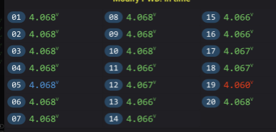

On my BMS I have a cell group that is about 0.02v lower than the rest of the groups at 90% charge. The rest of the groups are all within 0.005v of each other. I noticed when riding hard last night I managed to fully drain the battery to the point where the BMS shut off. I looked at the voltages and that group was at about 2.8v while the rest were at about 3.2v. That group has returned to the usual 0.02v offset after recharging the battery.

Thanks for all the helpful info, after charging the bike it looks like the group I'm worried about (group 19) has been slightly overcharged. I will keep an eye on it.

So group 19 was the one that dropped to 2.8v before the others? And now it's a bit higher than the others? Sounds like it's just a weak group. Could be because of poor welds, could be because you just have 1-2 bad cells. Only way to know for sure is too physically inspect them and/or capacity test each parallel group individually.

Here is the snapshot i took about 2 hours after charging the battery last night, note that my charger is set to stop at 4.05v. I also disabled the balancing feature to see what that group would do when sitting over night.
Total battery voltage reported as 81.39v
Here is the snapshot about 10 hours later. Total battery voltage reported as 81.34v.
Most of my groups are within 1-2mv, basically the BMS's maximum resolution. Group 19 was overcharged by about 8mv, and then dropped a total of 17mv which puts it as undercharged by about 8mv. Is this anything to worry about? Should I let the battery sit longer and see if that group keeps dropping in voltage?
My balance setting triggers when group voltages are greater than 0.010v in difference, maybe I should change it to something like 0.030v?
That's not a terrible idea. I stand by what I said earlier, that it looks like you just have one weak group, which isn't the worst thing in the world. See if you can get repeat data for the bottom of the charge curve.
