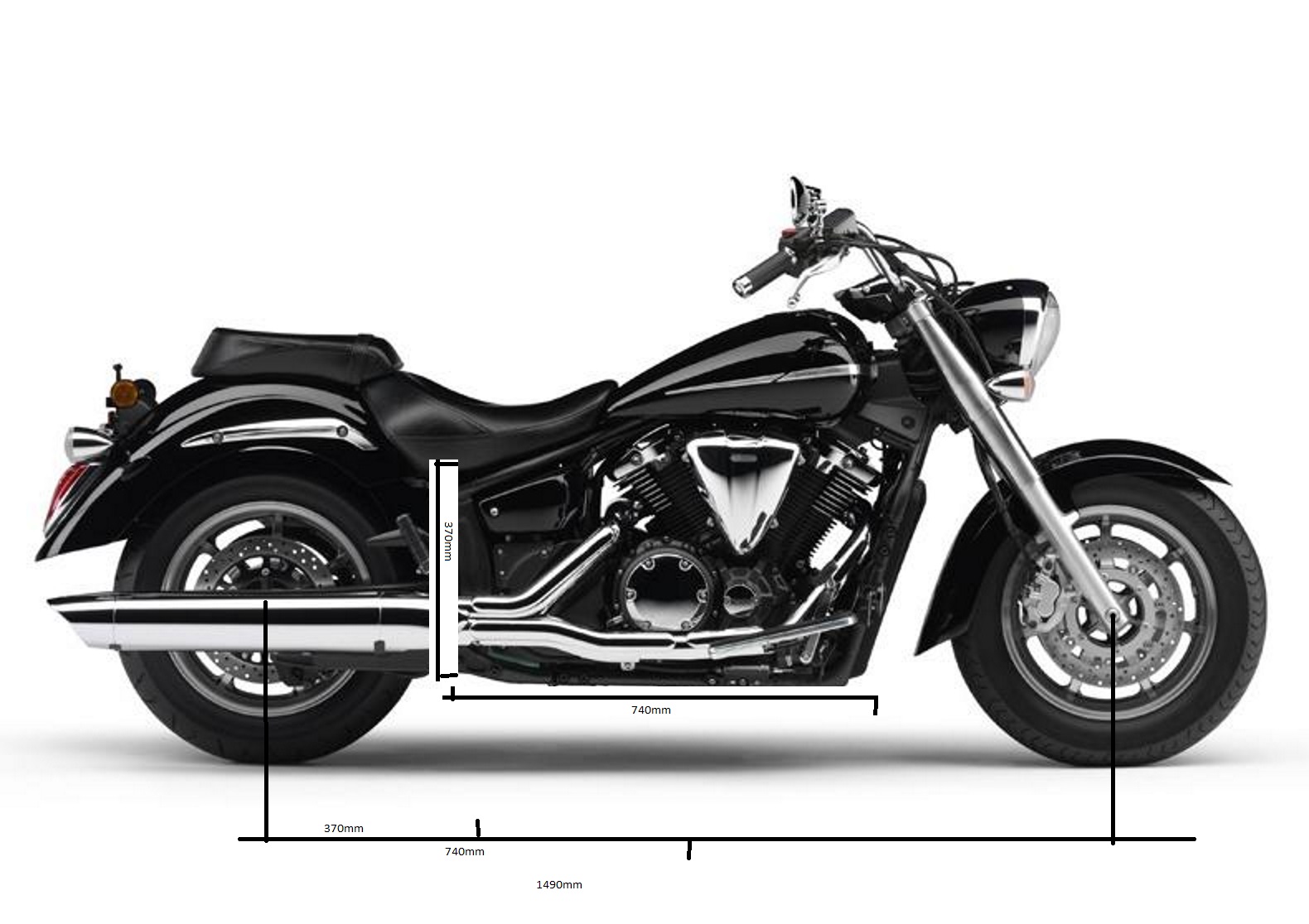

Currently this is the bike that is a potential doner, the Yamaha XVS 1300A or perhaps it's baby brother the XVS650.
The XVS1300A has a belt final drive, 30:70 final reduction, and rear wheel of 170/70R16 with a rolling circumference of 2044mm

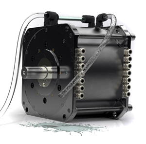

Get a watercooling setup for the motor and controller for keeping the temps down under high power operation.
Just a quick bunch of measurements from counting pixels, you could fit 20 modules inside the frame in one continuous group for 20S 2P, however, if you're really good friends with a welder, cut and stretch the frame by say 4 inches and you can fit all 24, that'd give you a real nice pack voltage, then stick a big controller under the seat, a contractor and dc-dc in the old fuel tank.
http://www.cnqsmotor.com/en/article_read/QS%20Motor%2017X4.5inch%2012kW-14kW%20273%20Water%20Cooled%20Electric%20Motorcycle%20Hub%20Motor/538.html
I think you'd be looking at a bike that weighed very similar to stock, had reasonable power and could do 100miles on a charge.
I don't think peak power is an issue for that hub motor but continuous power would be - hence the water cooling.
